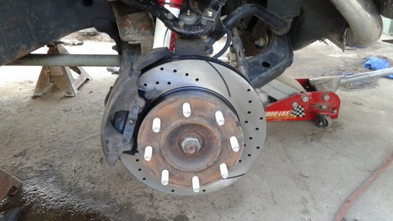

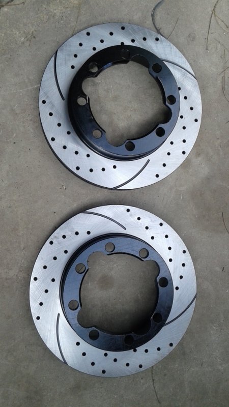

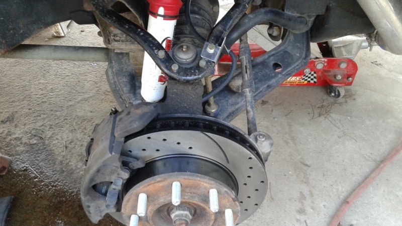

I've known for awhile that I was going to need to do front brakes, as the pads were getting thin. My front rotor were cupped (looked the last owner had just slapped pads on without turning the rotor, maybe a couple times), which I've been known to do on occasion, especially on the "pain in the rear" type like these 4x4's. Since I had some ahead of time warning, I did some researching to see what the best was I could get on new rotors. I was surprised to see I could actually get drilled/slotted rotors almost as cheap as regular ones, so I figured "why not", it can't hurt. I bought these. http://www.ebay.com/itm/181617850351?_trksid=p2060778.m2749.l2649&ssPageName=STRK:MEBIDX:IT

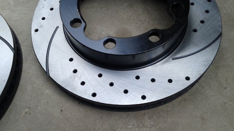

The quality seems pretty good on them, and they are very thick. Even with the caliper pistons fully compressed, there was just enough clearance to slid them back on with the new pads. They run very true with no pulsing in the brake pedal, and they're performance seems good. I don't notice a big difference, but the brakes do feel stronger. I'll be curious to see if the help with brake fade when pulling a trailer. I have several trailers, and while my car hauler has trailer brakes the other two don't, and when I'm pulling them, my brakes leave something to be desired.

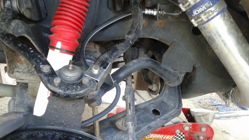

I used a good set of pads ($40), not the cheap $12, and $20 dollar ones they offered below these. I had to replace the brakes hoses too, as they were getting very cracked. While, I was in there, I replaced any wheel stud that I couldn't turn the nut off of by hand once broke loose, which was 8 out of 16, as well as lug nuts. My total in parts for this job was was $162 including the rotors.
I'll be curious to see how these rotors hold up, but for the price, you can't go wrong.
