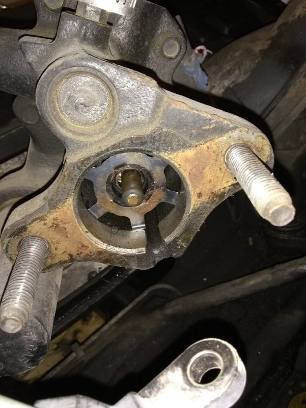

I had one pump start leaking on the alignment rack because the shaft wasn't touching the seal on one side sudden like. The shaft moved because the bearing let it move and all the bearing metal had to go somewhere. It ran for 30 min total since install. The oil was a glitter globe. I replaced everything, flushed the cooler, and put a filter on the return from the steering box. @ak diesel driver is correct: big job to replace the box, hydro-booster, and blasted PS pump again. I went through 5 PS pumps with one DOA like yours before I figured out the above way to obtain a working PS pump.
Pic on post 12 of bearing clearance you can see...
