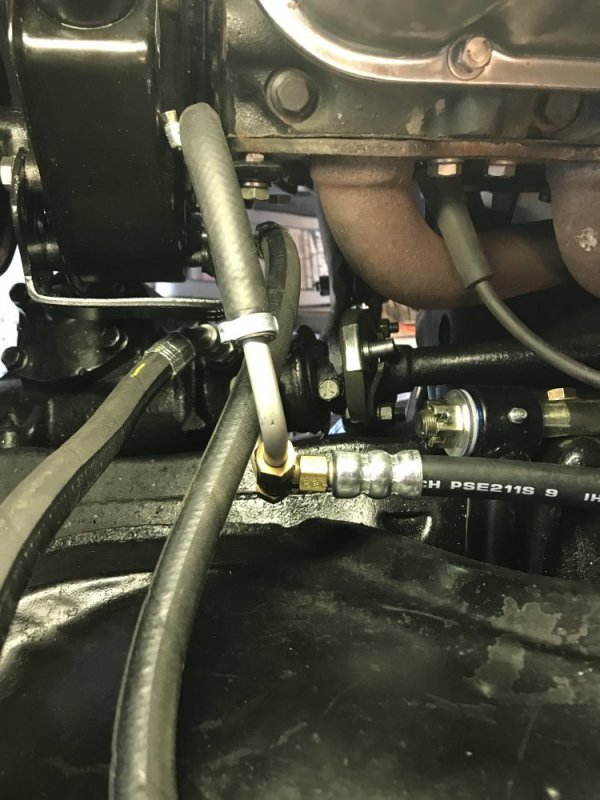

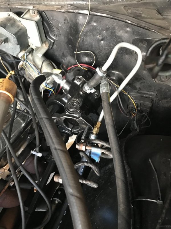

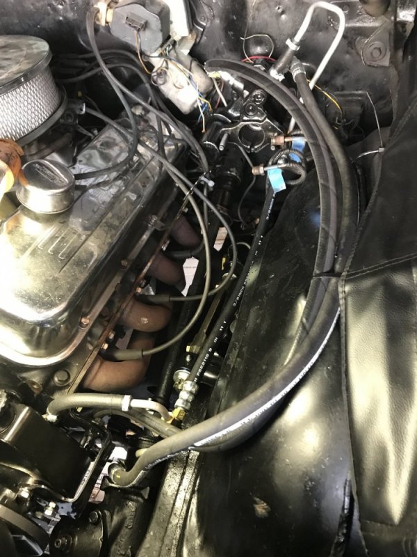

Found a spring and retainer. Tried bleeding the power steering and it’s really foamy. Let it sit a day, no foam tried bleeding again and foamy! Also, my brake pedal is actually being sucked to the floor!,! I can pull it up and it sucks right back down. Checked hoses for proper routing and according to the diagram from CPP it is correct. Outlet next to the return line goes to the gearbox, outlet on the opposite side comes from the pump. Kinda frustrating
Pic of line setup? Esp of booster.
You should have a 3rd "return" line from hydroboost to tank of PS pump? Any restrictions to that true return line and it would prevent the brakes from releasing. This includes filters. (Filters go on return from box to pump.) If you plumbed the HB return to the steering box that could do it...
IMO you got it backwards. Pressure from pump to Hydro-booster then from booster pressure to gearbox. So Pump, Hydrobooster, then steering box.

That’s how mine is plumbed pump to booster booster to gearbox. T in return line
Our trucks have 2 return fittings on the pump tank. Not saying it's wrong what you have. Again any restriction in the return can muck up the works where the spool valve in the hydro booster will not release. If you are satisfied with that then we:

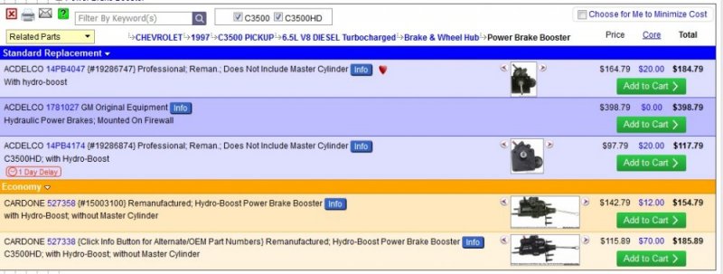

Does that site just sell rebuild kits or do they sell remanufactured hydroboost pumps.? I'm asking cuz mine is completely shot.. no power brakes at all and I have to add power steering fluid every other day.. checked all the local junk yards and none of them have one they say mine have to come off a 95 - 2000 truck. Honestly not sure if that's right or not ...just know it would be nice to have good brakes again..
Where is the leak?
Have you run the system "dry"? If you ran the system dry: Flush the cooler, replace everything else. Yes: PS Pump, Hydro-Boost unit, hoses, and steering box. Because you will never be able to flush all the metal debris out of those parts from running it dry.
@RockAutoLLC RA isn't bad prices.
