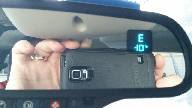

Well, it has been mighty cold lately. I filled my tank and used a double dose of power service white. I refuled at a half tank and double dosed with power service white again. I new the truck would be sutting for a couple of dsys, so I wanted it to be full. I went out this morning and it started right up. I let it warm for 10 minutes and then took off. I drove about 4 miles on side streets. It was a little slow, so I babied it. When I got to highway I accelerated slowly. When I got to 40 mph, the engine sputtered AZ bout three or four times and then check engine light came on. I took next exit, turned around and went home. It drove fine on way home with CEL on. I immediately ran the codes and got the low fuel rail pressure code. I added Diesel 911 to the full tank. Hopefully this does the trick.
Anyone else experiencing any issues due to the cold?
