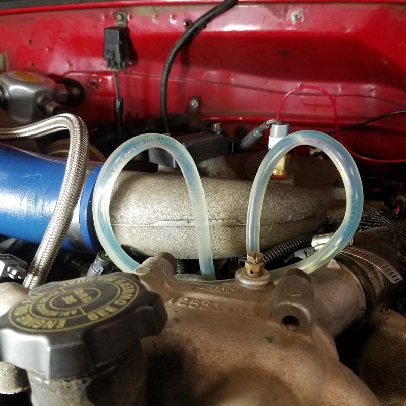

After you replaced the lift pump and did 3/8” line all the way to the ip (great upgrade btw), are you still getting the bubbles? Yes, only after an overnight sit. It think the bee bees are micro bubbles gathering over night. At one point I made 2 loops hoping to see what side they were coming from? I forget which earlyer sequence this pic was taken but look close there are small bubbles on both sides. I'm going to set this up again just to keep an eye on things. That vinyl line does not last too long.pic of clear loops.jpg

It is normal for a tiny amount of air to collect in the return line. The system was designed to do that and have a high point out the ip for the air to escape. That small amount of air won’t do anything.

It is normal for a tiny amount of air to collect in the return line. The system was designed to do that and have a high point out the ip for the air to escape. That small amount of air won’t do anything. Good to hear, that puts air being the problem off the table. I was told there should be "0" air in the fuel system.....
