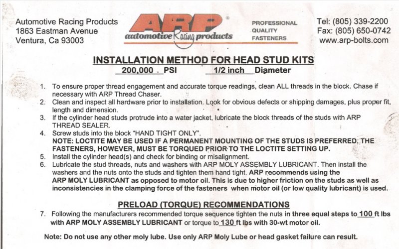

Stop the confusion on torque values! It varies depending on what lube you are using on ARP Studs. (N/A: TTY GM Bolts be covered elsewhere.) You want to use the ARP Moly Lube. period. There are studies of the torque changing if you use 30 weight oil and have to re-install the heads several times. ARP's stuff does not experience the torque changes after repeated uses.
2009 install instructions that may have changed due to wet hole leaking that has come to their attention. Do not use ARP Thread sealer as it will leak.
Agreed over priced sealer i used that stuff on a 383. And it was junk i used black permatex and now with 130,000 miles no leaks

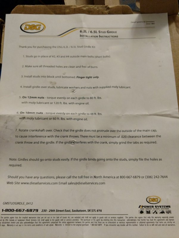

Gonna ask as reminder - anyone with the ARP paper for recommended torque spec on main studs- please put a pic here so all this stuff is on 1 thread. It will be a while yet before I order my set.
On the sealers, just like torque specs- I like to say show what spec is. Personal deviation is up to the individual. Me- head studs get tightened not snug. Mains get snug not tightened for my belief of whats better.
