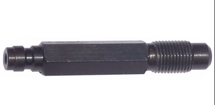

when looking for the adapter. even questioning if the kit has it included the thread pitch is 10mm x 1.0. the adapter will look like this one, it has a schrader valve in the threaded end.

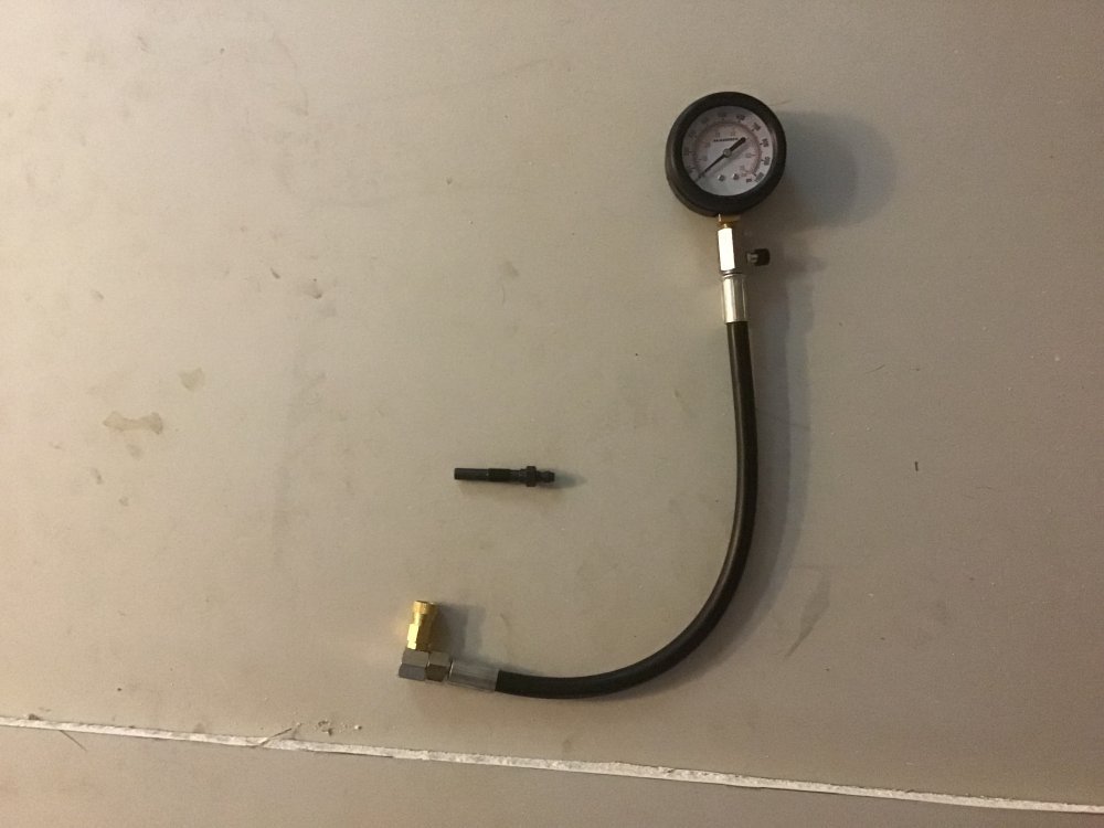

went to hook up HF cheap comp. tester and adaptor to short dammit 😩. When back to HF and upgraded to the Master test kit w/ the extension hoses. Will be getting back to it today. Yea I was surprised how much coolant was coming out of the coolant passage on that side. Maybe with luck #7 still has good compression. My plan is ( if the rest of the cylinders test good?) try to snake borescope through valve guide to check for damage, slap a head gasket on that side and recheck #7. I’ll just be out gaskets and studs 💁. I will be no where near the tester👍. I hope the wet cylinder doesn’t fool me on test reading. The coolants been drained, lower hose off. Maybe I should pop the heated freeze plug out. I hope a little coolant won’t hurt the tester since I have the master set LOL . Thanks again.

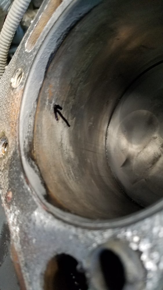

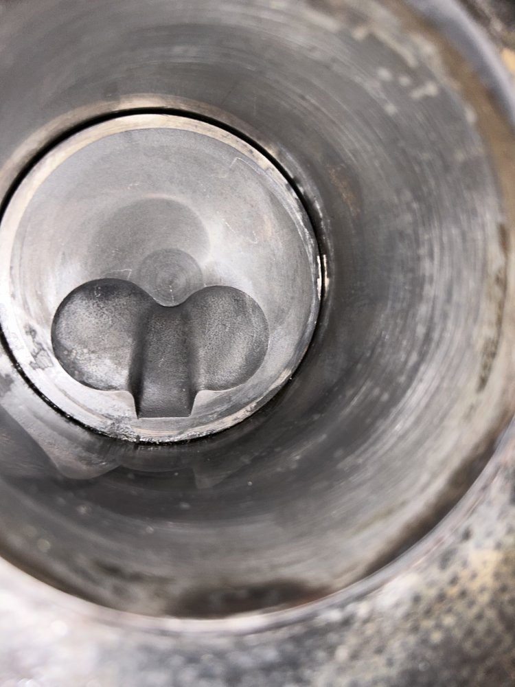

That's what happened to my 98 with just over 90k miles...it was passenger side rear cylinder...waste of a good running engine. There were no other issues and ran great but, the block was cracked. I initially thought I had a blown head gasket because it sat for 2 weeks and when I tried to start it it hydro locked. Pulled all glow plugs and liquid came out of the rear cylinder. I still thought maybe it was fuel and had a leaking injector but, further investigation indicated coolant...I was thinking head gasket til I happened upon the crack. I had no idea the 97- 98 models were prone to this.
The piston was at the bottom of the stroke (luckily) or I wouldn't have seen it. I first noticed what looked like perspiration where I eventually noticed the crack (Sharpie arrow indicates crack).
I fixed it with a new GEP long block and sold the original for parts.

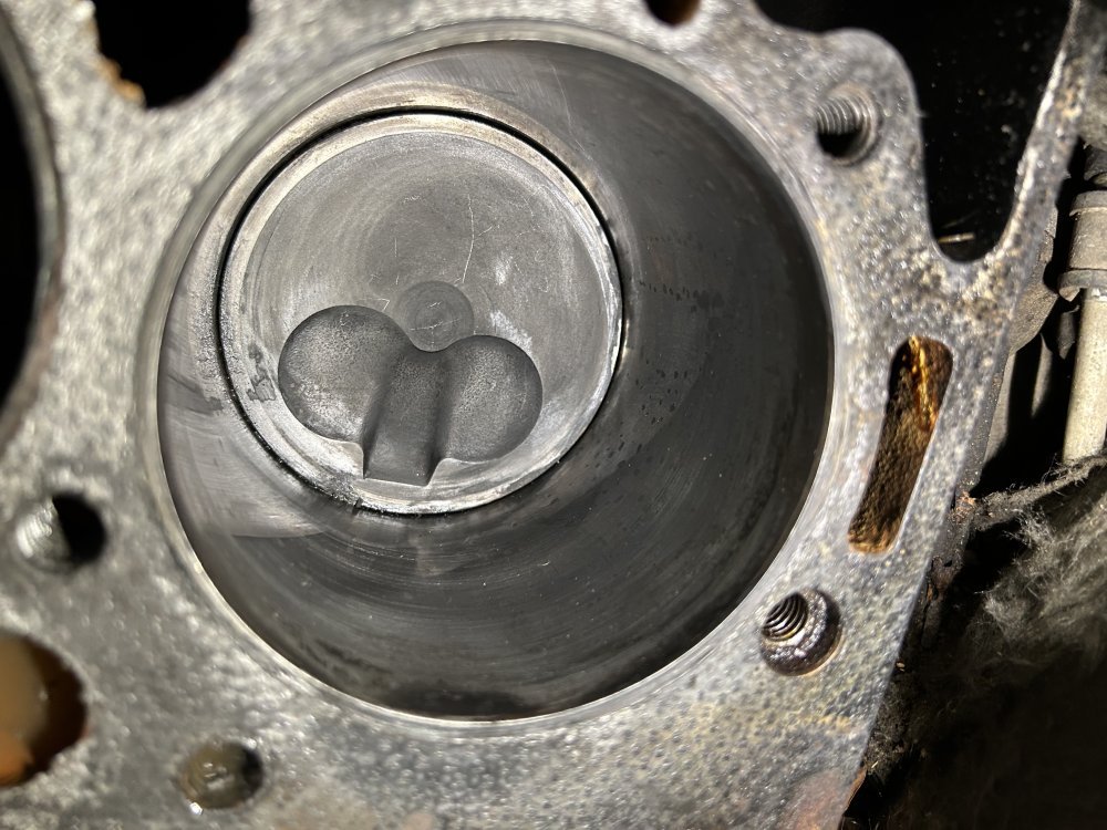

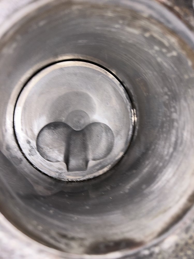

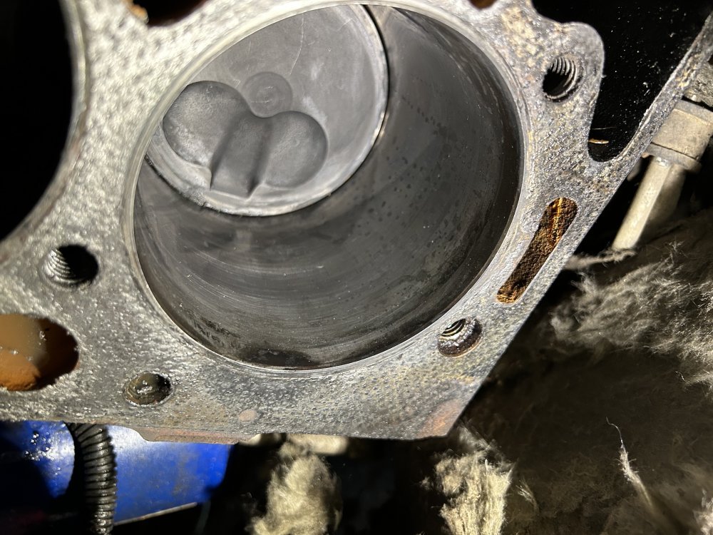

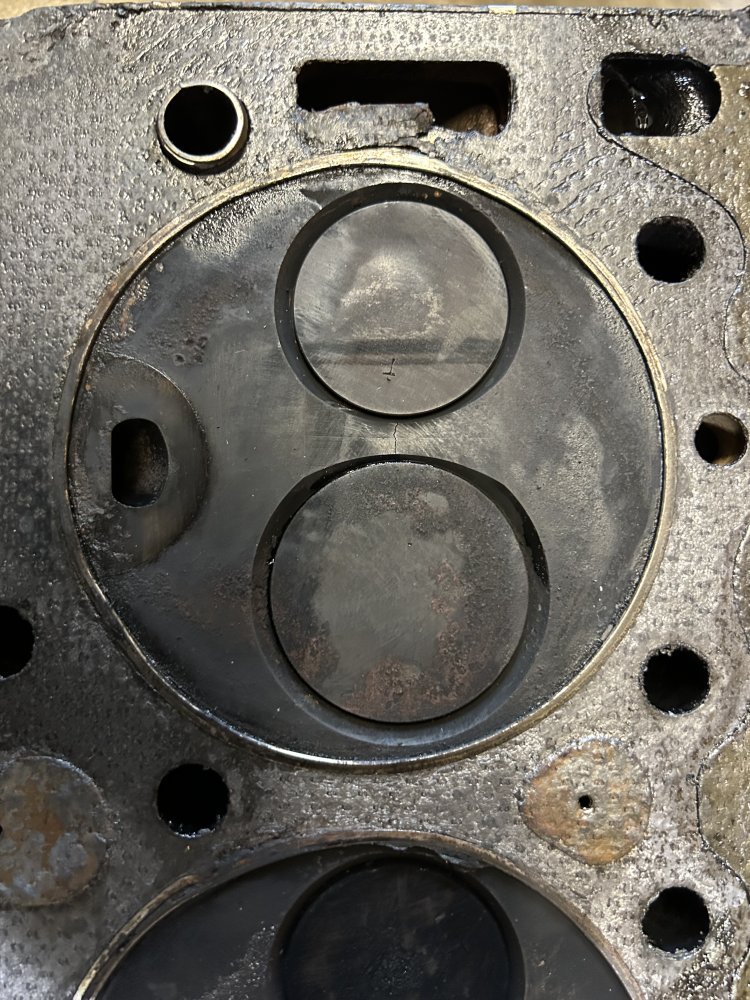

I did the compression test and got the head off today. The only thing I regret is not warming up the motor before tearing into it and doing the compression test. The cold compression test : #1:295 #3:250 #5:250 #2:280
#4:285 #6:275 #310. did each each one twice and these were the highest, cranked for 6 revolutions. Does not look. Doesn’t matter the head gasket did not have any damage. Looks like I need a motor. Could not see anything in the cylinder Like wreckenball67,s. But with the gasket inspection and the amount of coolant coming out of the passage like will said I’m pretty sure. Thoughts? The tear a the top in the picture of the gasket is my fault Oops! Pictures aren’t to good hard to get to. Thanks guys.

You know what I see in the top photo of that head? A crack between the seats of the intake and exhaust valves and definite signs of burnt coolant around that crack! Which Cyl # does that go to? If it's the one you found coolant in, there's the source of your leak, not a cracked cylinder!
