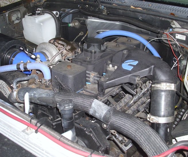

Drive it daily. Its great. Keeps temp perfect. Tows what I need to. Still some relays and wiring to finish for my cold days intake heater etc. The pair of duramax intake heaters work great by the way below freezing. Trans controller feels settled. Oil analysis just came back clean and average.
Im looking at additional crank venting. Possibly through a CDR to the air cleaner from the oil filler neck.

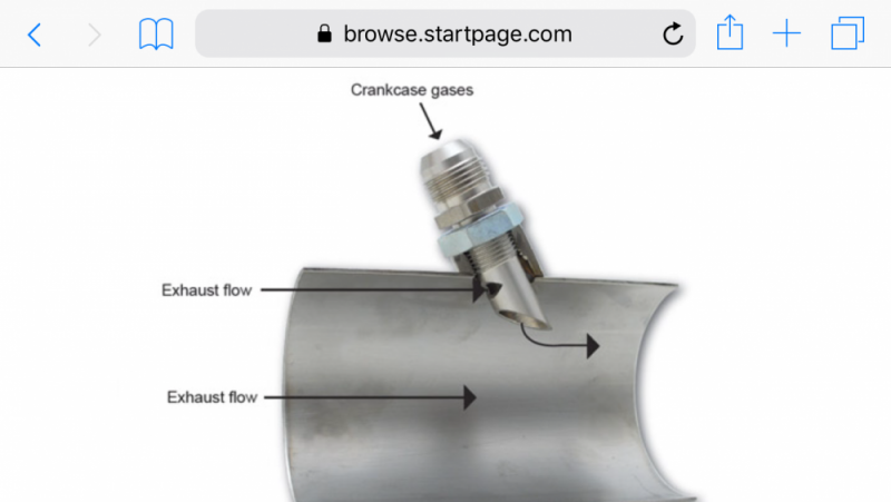

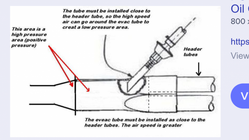

You might want to look into the valve cover venting plumbed into the downpipe with a vortices tube and using a check valve the vacuum created will pull and incinerate whatever particles present.

I would include a catch can. The more vacuum -the better.
But why just shove oil out the exhaust? Recover it in a catch can. I got a provent 200, but it isn’t the best choice for going under water due to the regulator in it.
You just run vent line through catch can into draft tube in exhaust.

YES! Provent is perhaps the best way.......the dowpipe setup will because of high EGT's under boost incinerate whatever escapes the catch can.

On another note the valve cover vents on the Cummins separates the oil allowing it to drain back into the diesel through the valve cover. I have quite a few miles on my conversion and the hose from the valve cover vent is dry & w/o oily residue.
