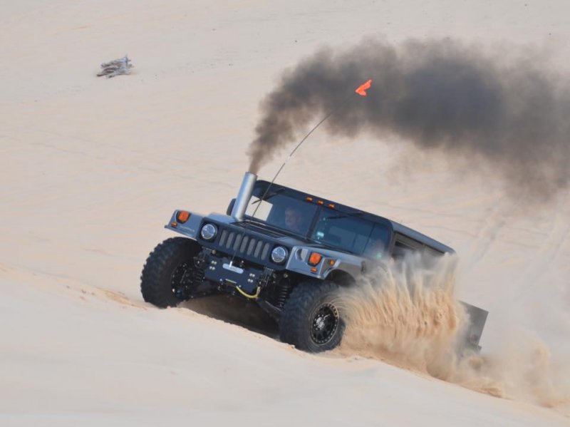

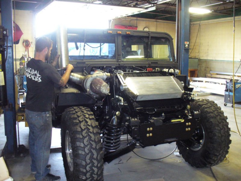

Dude! That is awesome! I would love to see more pics and here details if you don’t mind.
Paint scheme is cool!

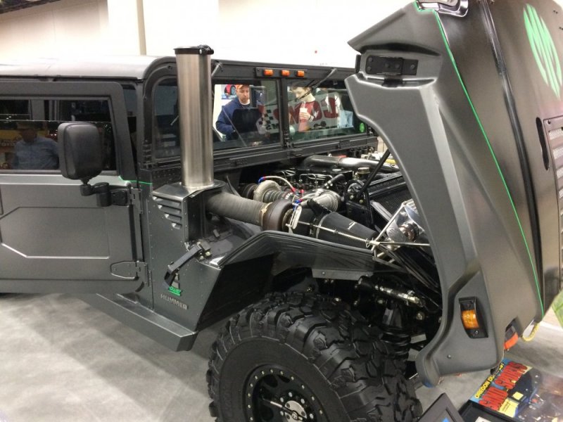

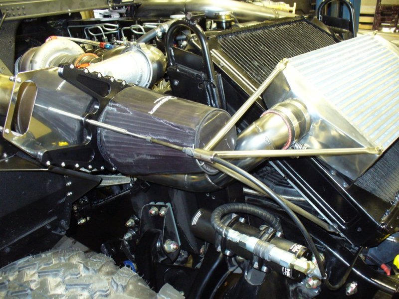

The exhaust going up where the intake was is ingenious. I thought about doing one on each side because I like to ford water. But if you don’t than cool set up.
How high body lift?
I see brushgaurd mounts on the air lift hooks but no brushgaurd?

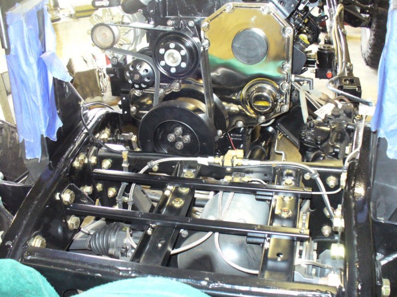

What is the cylinder on right front of frame with hydraulic line & quick disconnects?
Man I want to see this thing in person. So much nice work on it.

This one doesn't do fording, he loves to play on the sand dunes.
The Body lift is 2 inches and we ended up with solid mounts for the motor. Too much torque twisting. I will be making some upgrades on it later this year and I think I have a way to give it some compliance and keep the motor twist to a minimum.
He decided he liked it better without the Brushguard better, so we took it off.
The Hydo line, cylinder and connectors are for the shocks. It has the Rod Hall offroad racing suspension setup.

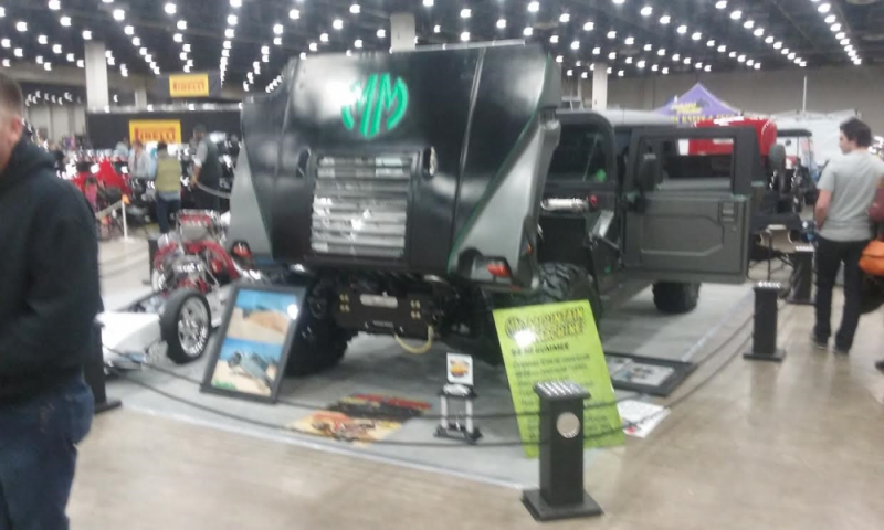

It may get to your neck of the woods, we had some inquires about taking it to SEMA.

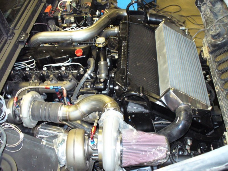

Nit Pick: Why are you using a Garbage K&N type air filter that lets more dirt through and plugs quicker than a paper air filter? (They are not even show use only worthy as they don't deserve the free advertising.) That expensive build deserves better. Once you dust the rings it's over. There are better filtration dry aftermarket air filters (not paper) available today if you must have aftermarket. I have walked over K&N letting so much dirt by it screwed up the idle air control to where the engine wouldn't idle.

n8, we'll be there this year with a couple of other vehicles. One is the bike we finished belonging to the fellow in one of the pictures called "Boba Jaga". We plan to have at least one H1 there next year.

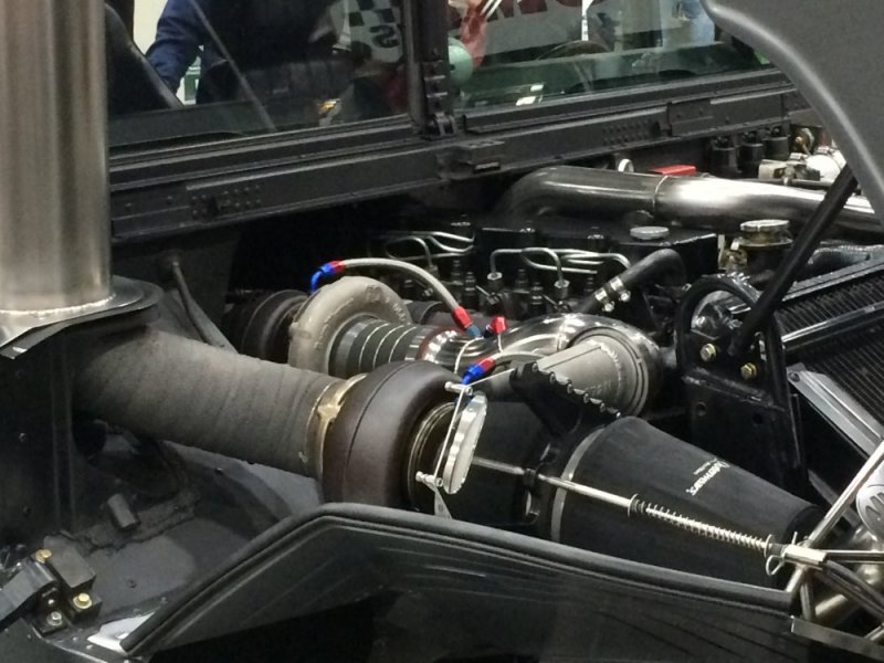

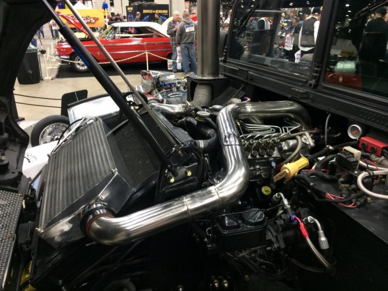

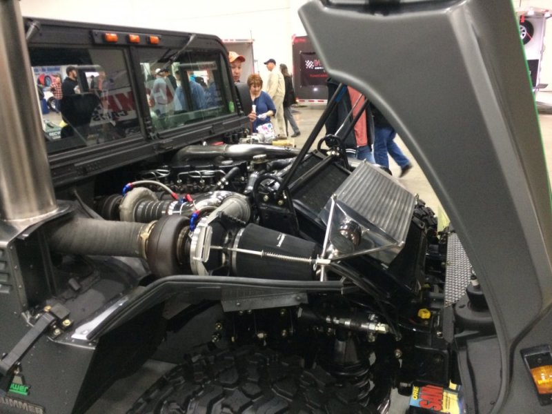

Cool! My brother and I go every year. I’ll look for you and your builds. In fact, that Hummer was one of the maybe 5 vehicles I actually took pics of. Here are my pics. I guess I was a bit focused on the engine bay, ha.
C89C59DD-0263-4AA5-B50C-50EFC83FC291.jpeg 1CDCD2F4-46A3-4C62-BD76-B04B78BC1647.jpeg DBD30B0E-072A-4578-87B0-9969CCAC3906.jpeg AAB2E19D-D6F7-4280-BD9B-90F58C036D32.jpeg
