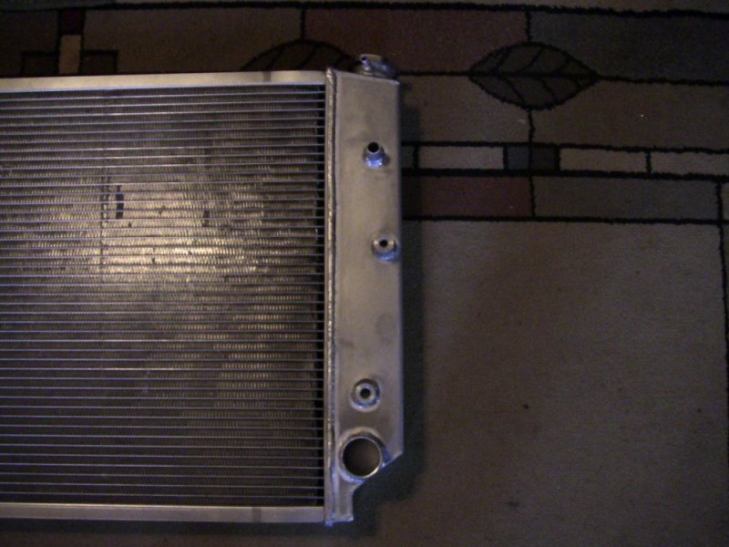

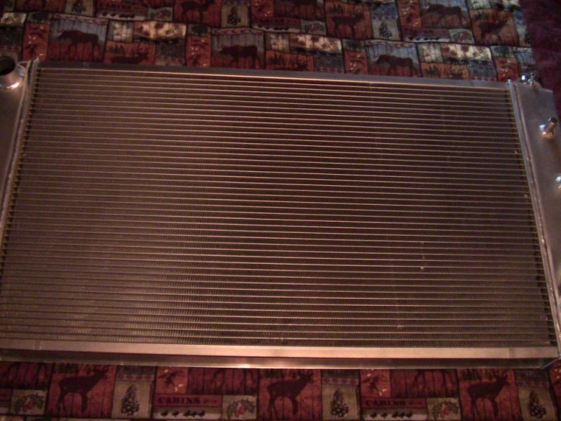

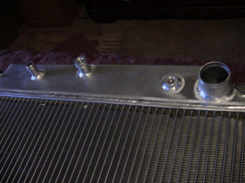

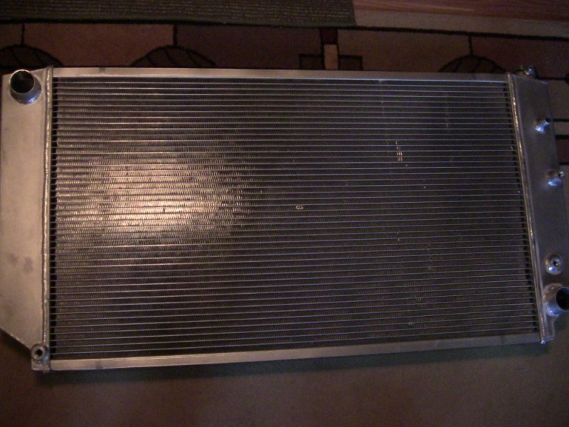

We went down to the Griffin plant 2 weeks ago and I ordered this radiator. I wanted a 1/4" bung above the bottom hose so I can install a temp sensor matching the motor sensor, plan is to wire a toggle switch so the gauge will read either sensor. I wanted to be able to monitor the water temp entering the motor at various times.
This unit uses two 1-1/4" rows, Griffin says around 15-20% more capacity than a stock 4 row radiator. I will be checking this with my stock brass unit, I will plug all the holes and fill both up and see what the difference is between the two..
Hopefully this weekend I will get this all prepped and sprayed with a thermal dispersant...
If anyone wants a top quality radiator that is really made in the USA this is a nice unit.. not cheap but well worth it for hand built & welded....
