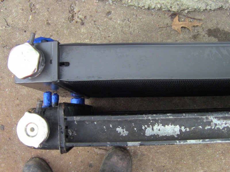

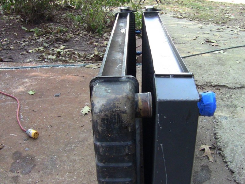

Did you do the coating your self? And how do you go about curing?Coated, now for the curing....
Measured the core, 2 3/4 thick, after it's finished curing I will measure each radiator and see what the difference in volume is...
Awesome. Thanks.Yes I did, this is a new Techline product that air cures, no need to bake, just etch spray and wait, it is fully cured in 7 days....
Made for things that can't be baked like radiators & intercoolers that have plastic tanks...
