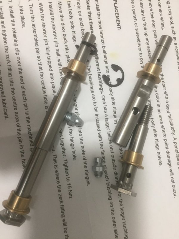

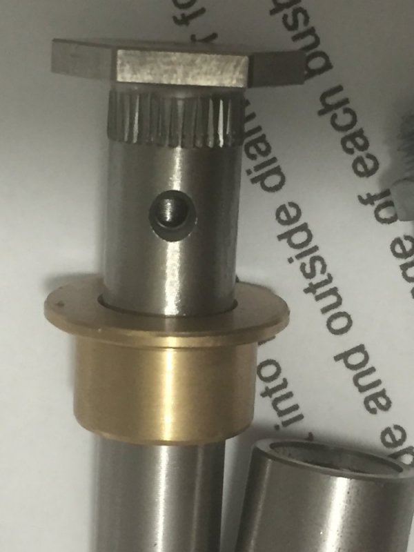

got this in the mail.
Houston?

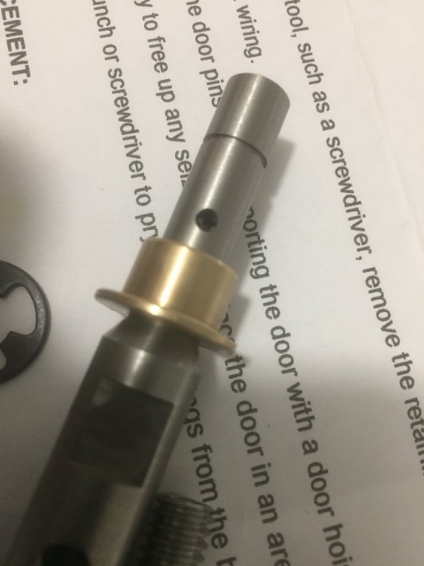

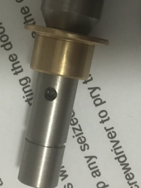

here one is assembled.

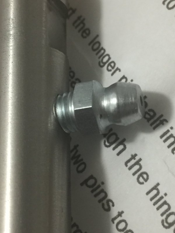

the small holes is where the grease lubes the machined brass bushing.
insert grease here.they feel/look well made. each set is for one door: upper and lower.only my drivers door needs help so one set is all i wanted.
i'm recovering from an injury so it might be a minute until i get to them.

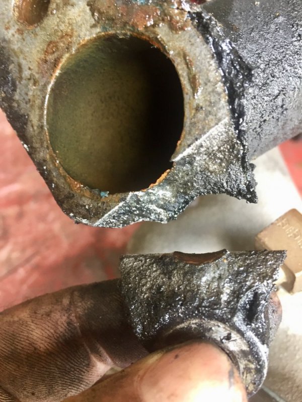

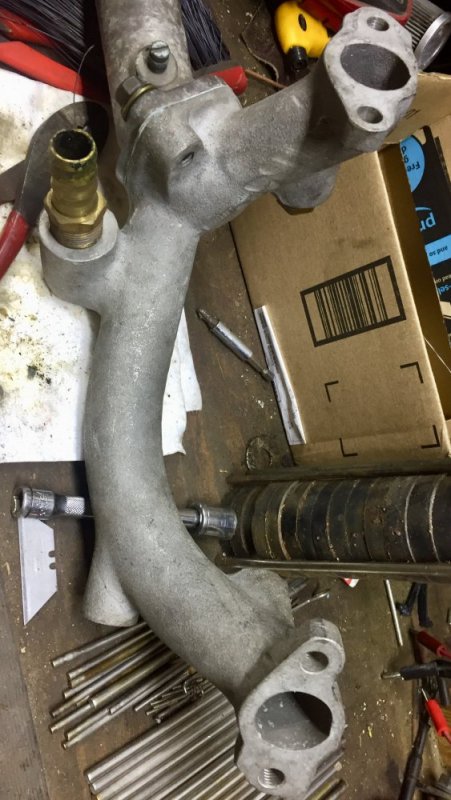

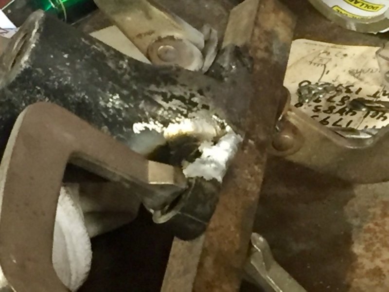

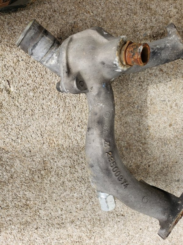

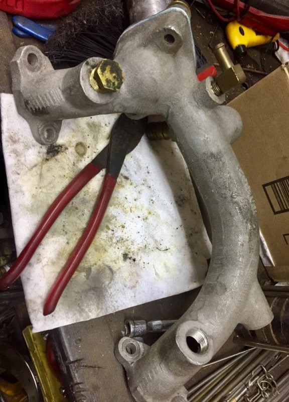

meanwhile, and more pressing,. my coolant crossover has decided to corrode enough to start leaking. and i don't want to spend a ransom on a replacement so i'm gonna come up with a low cost solution by using a HHMMV unit.

Dont do it. The hmmwv ones are a piece of junk.
Takes different stats also.

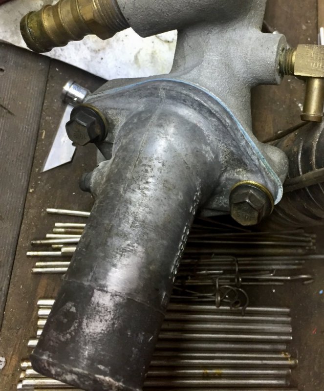

I would remove yours and clean it up, then use jbweld if you have to for now. I used jb weld on one before and it lasted years.
looks really simular to the one in it now except neck location. using the 96 neck.
i will give it a better look when i get it off. already have the t stat.
Houston?
View attachment 57348View attachment 57349View attachment 57350
How did these pins work out?

unfortunately they are still sitting on the shelf.
i'm having health issues and want to get that taken care of first. shouldn't be too long. scheduled Monday for the cath lab.
