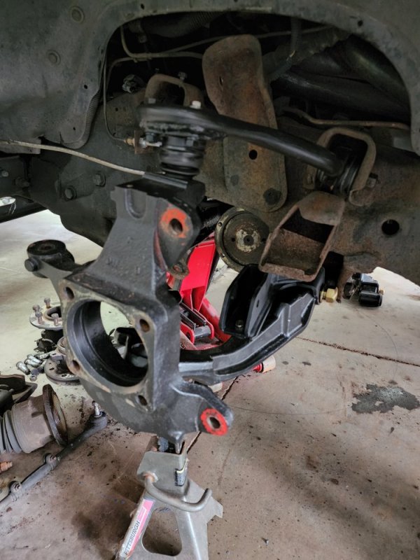

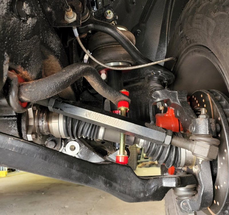

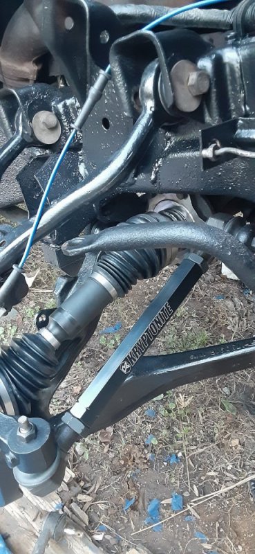

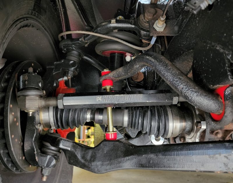

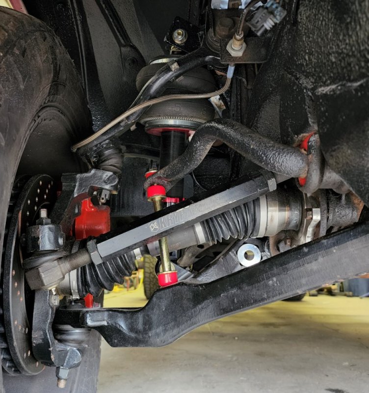

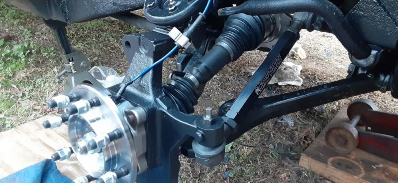

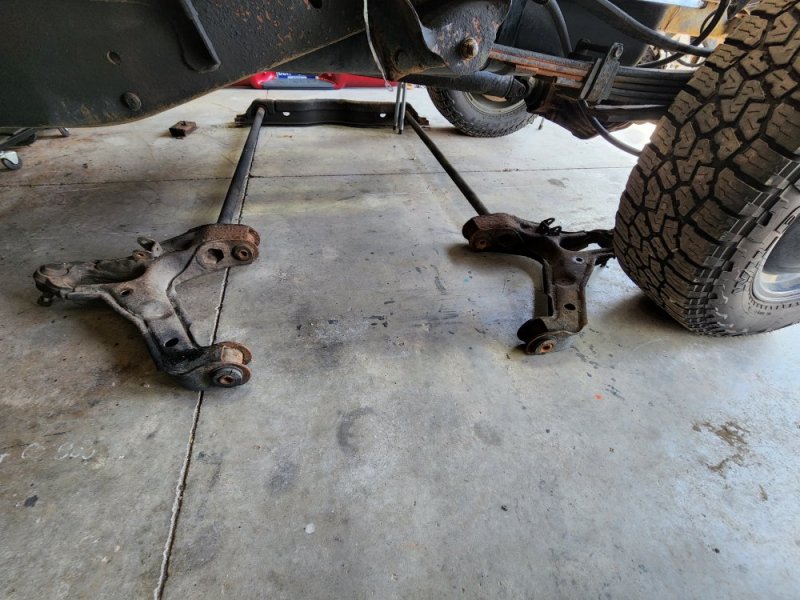

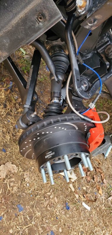

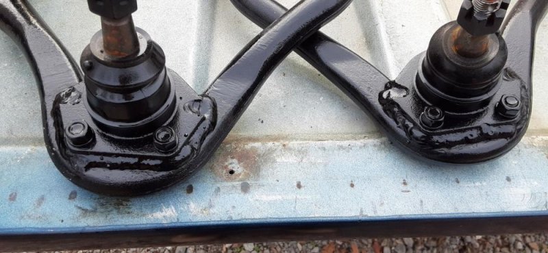

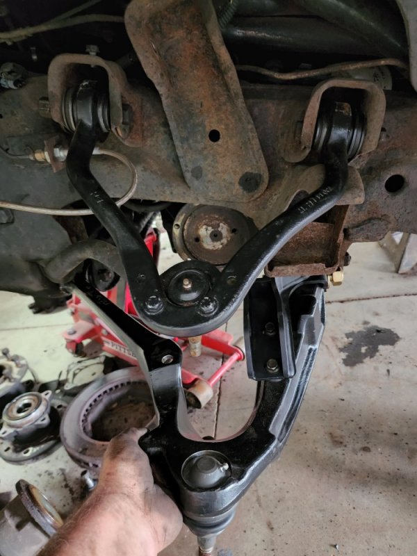

I've done a few of these now and I've found the easiest and best way (maybe not cheapest) is buying new moog lifetime lower control arms gmt800. They already have new bushings and ball joint, you do not have to ream anything. Gmt400 upper control arms then install kryptonite 6292 ball joints. The outer 2 holes line up, tack weld the rear then drill and bolt.
Kryptonite also makes tierods that are beefy and work great with gmt800 spindle to gmt400 center link.

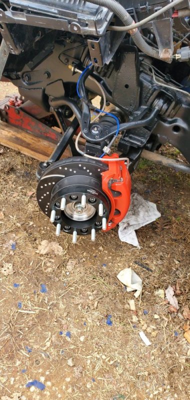

Thank you, and thanks to M.Kasperan whom I believe did this first brake upgrade like this. I just didn't want to ream out the spindles or modify the tierods. In Tennessee I believe there is a state law about steering modifications. I just didn't want to risk it with modified tierods.

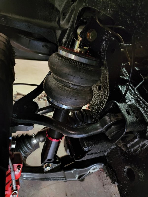

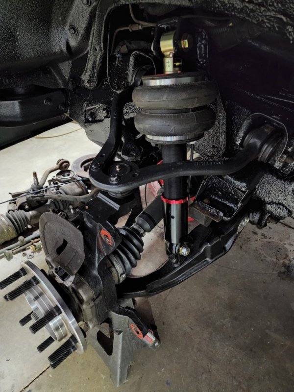

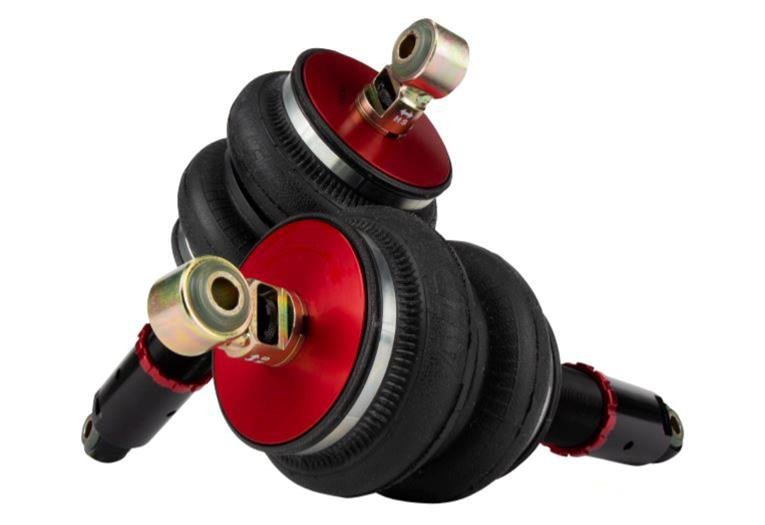

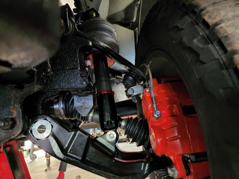

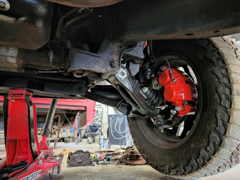

No torsion bars. Airlift builder series coilover, 3 inches coilover adjustable, 4 inches air travel. I'm still working with them, they take a lot of pressure to lift do to the weight. They are rated at around 2,000lbs, and have 30 plus adjustments soft to firm. I scaled out the front but need to figure sprung weight. I'm working on this for coilover, bags, or even hydraulic suspension.
I like a bit of a lift but being able to lower for getting stuff on the roof rack, into my tool box etc is a plus.
I have high articulating cv axles, wheels are 20's fuel forged.
With this new spindle you could go with ssbc calipers or wilwood even makes a brake kit
I'm also triangular 4 linking the rear with bags for getting into bed, hooking up trailers, and better ride.

Airlift builder series shocks come in many different configurations. In your case with a 2wd, do you have a trunnion (the bar through it) on the bottom and a stud on the top?
Is your truck a big block?
Then you need the length, mount to mount the max compressed is a little under 11 inches and extended is about 15 inches.
2wd trucks have a lot more options and a lot companies for bags or decent coilovers.
on mine, the LCA is a stamped steel normal control arm that the coil spring sits on with the shock going up through the middle of the spring. on the top side the frame has what I call a big upside down cup that the spring sits in with the shock up the middle with a threaded stud with bushings mounted on the frame. no trunnion unless I misunderstood what that is. in your posted pics, it looks like you eliminated the torsion bars on the LCA's. mine doesn't have torsion bars.

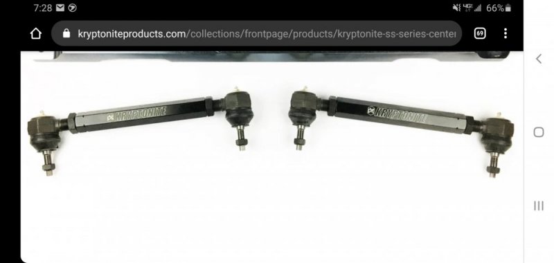

@Dustin Zynda thanks for sharing the info and pics, very nice looking setup. Those Kryptonite tie rod ends sure look beefy. So if I'm reading your post correctly the Kryptonite inner tie rods for GMT800 will bolt up to the GMT400 center link without modification?

DieselAmateur, that is correct. I purchased these because I wanted a strong steering component. With larger tires (33×12.5×20) not huge I'm always replacing front end part's.
They actually make them for 01 up trucks with an option to replace the center link on these newer trucks.
Reaming out the gmt800 spindle and modifying the tierods did not appeal to me and then using washers. I know gmt400 ball joints are larger and thank you to the guys that first did this conversion.

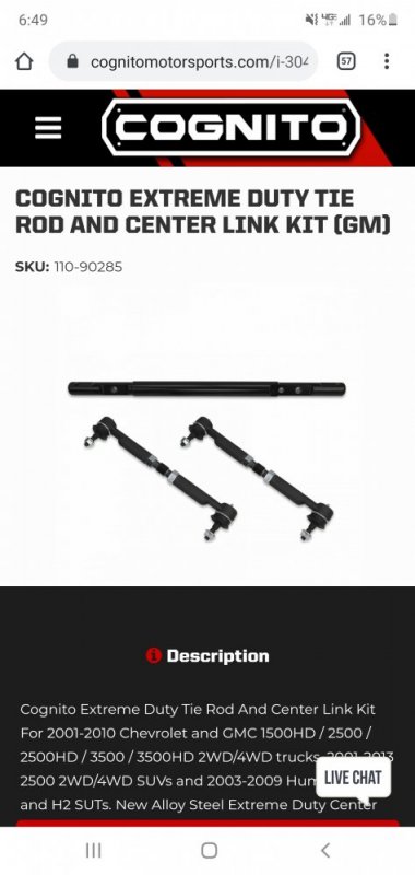

I searched and researched, found cognito and a few others that had the same set up before I found kryptonite. Other companies just sell the kit nothing separate. I called kryptonite they were very helpful. I explained what I was doing they said they would sell me tierods with the ends that I needed. Which are for the gmt800 spindle.
I thought that worst case that I would have to reem the center link but when I received them I realized they fit into the gmt400 center link
I will try to get better pictures of the tierods in the center link.
