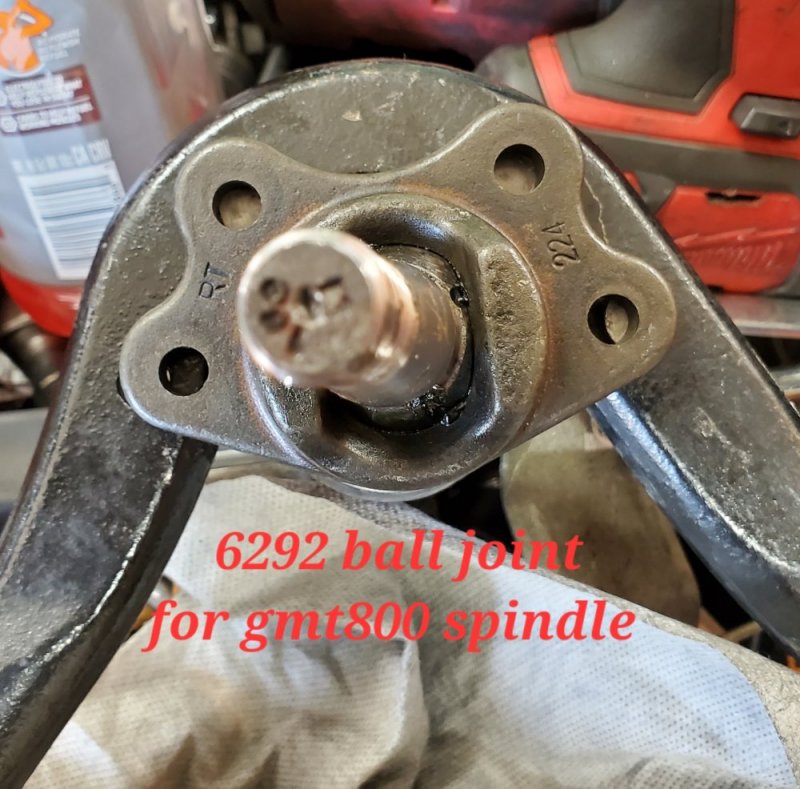

If you use the gmt400 upper control arms you can use the 6292 ball joints without welding them. Just find one with a large foot print, you can see where the holes are inner holes just barley line up. That part number seems to be a universal part number for that ball joint. Moog, kryptonite, cognito, etc use them in there gmt800 upgrade upper control arms. You could use parts store upper ball joints lifetime, I went with kryptonite because there warranty.

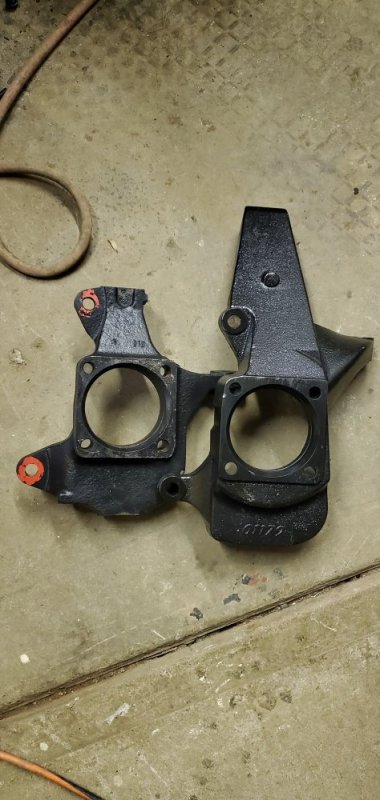

My first swap I bought junk yard parts, my second I bought all new parts. Spindles off Amazon for less then 2@$150, Detroit axle bearings 10yr warranty 2@$170, lower control arms 2@$300 or less lifetime warranty, upper ball joints moog lifetime warranty 2@$50, rotors 2@$200 3yr warranty and calipers 2@$150 lifetime warranty

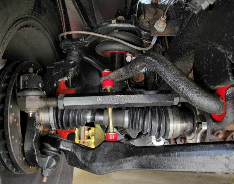

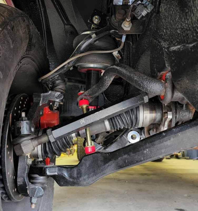

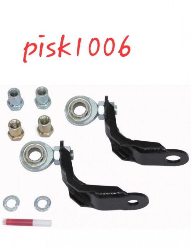

I also use supersteer support bracket $250 and th there are idler and pitman arm support brackets too $300

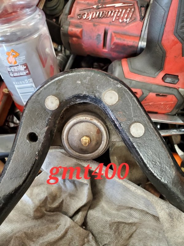

Could be, I found #6292 to be a gmt400 1500 upper ball joint but it could be, when I found that one I stopped searching and said close enough. So many parts out there I figured something had to be a close fit. Maybe an exact fit out there somewhere
Yes, this is the ball joint that will fit the gmt800 spindle without reaming it and the 2 front holes on the k2500,k3500 upper control arm. Again to avoid reaming out the spindles this is the option I used.

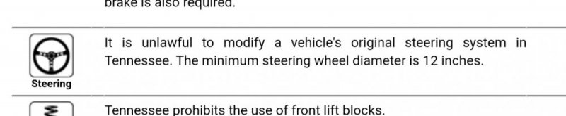

AGAIN Tennessee law prohibits steering system modification so "opening up my check book" I used a credit card BTW to buy an engineered tested warranty backed product seemed like the safest legal way to go. I have a lot to lose if my trucks steering killed someone because I wanted to be the cool kid that made my own parts.

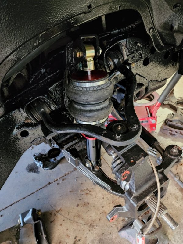

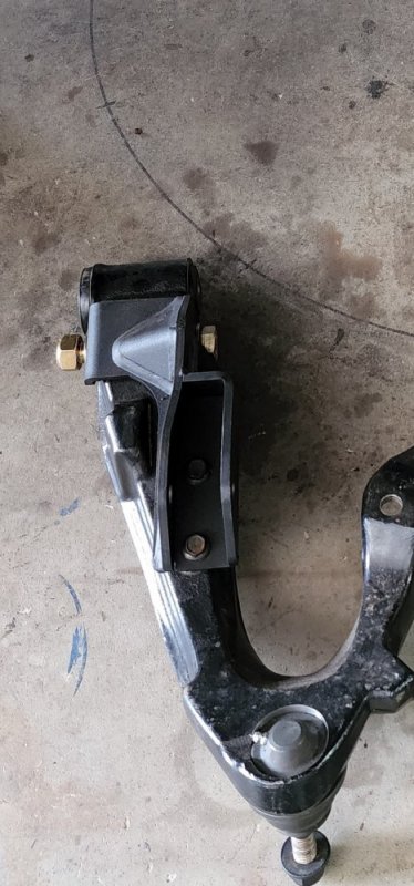

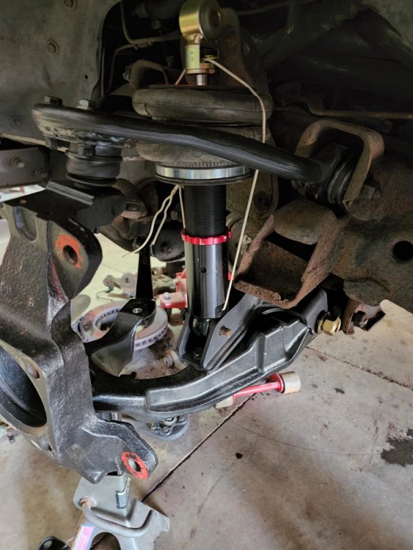

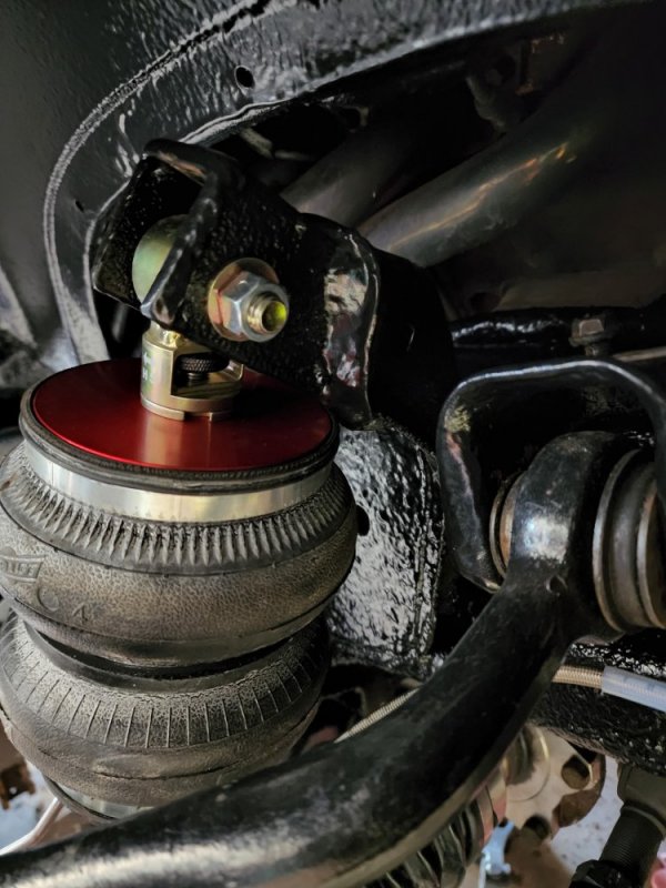

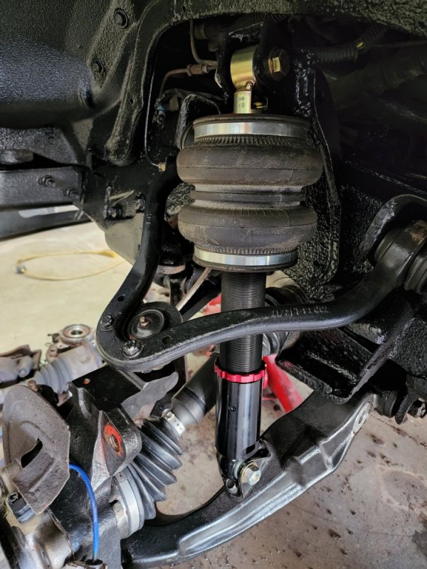

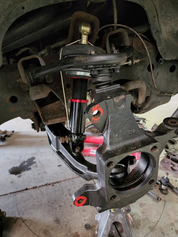

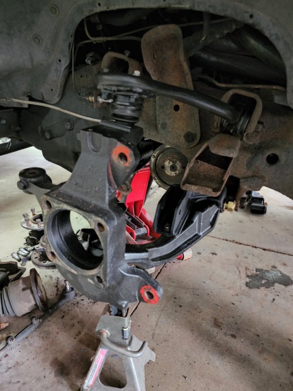

BDS makes a coilover conversion for gmt800 2001 to current 2500 & 3500 this is listed as a 4.5 lift. Well I own gmt400 trucks so with this brake upgrade I figured I'd try it on my truck. I called BDS and they said they would sell me the parts I wanted because I didn't want the hole kit. I'm not really a lifted truck kinda guy, I run 33×12.5×20s which doesn't require a big lift, bars are cranked up though.
I bought there lower control arm brackets, bolts, torsion bar filler and lift spindle. I bought the lifted spindle because with a little bit of lift I was hoping this would raise the upper arms to ease the ball joint and cv axle.
Overall I think that I wasted my money, the lca bracket they made hit the bump stop and I would have to cut it off. I used air lift air bag coilovers and they didn't fit into the bracket without binding up. They are built very well but we ended up just using the stock gmt800 lca shock mounts and welded in extensions for the upper shock mounts to bring them out away from the frame centering them in the upper arm. You can then use a coilover, bag, hydraulic or maybe air shock.
I'm trying to figure out sprung weight for coilovers spring rate. BDS uses a FOX 2.5 coilover I'm trying to figure out there spring rate a dampening.
Any of these coilover, bags etc are not cheap at around $500 each, air shock may be more cost effective but I don't know about the weight they are rated for. If you use air bags or hydraulics you will be able to lower and lift the truck around 4 inches but then you need to buy air compressors, tanks, controllers, 4 link and bags for the rear if you want to lower and lift that too.
I bought a 4 corner scale and my big block dually front weights are around 1850 each side which is air lifts max. This is not sprung weight though, I have to study on figuring that out yet. I've driven the truck only about 20 miles but it seemed to ride nice. I'm still working with it and plan on trying coilovers, hydraulics and maybe air shocks. I didn't end up using the spindles for the 4.5 lift because when I lowered the tru6 the upper ball joint was to high. I've found a couple other companies that I believe are shorter but I have not contacted them to see if they would sell just just the spindle.
An excellent explanation. Thank You very much.
I like the looks of those airbag shocks. Now maybe I’ll check around and see if there is a set for stock ride height GMT 400s.
Air lift makes them in different configurations they call them the builder series. They have 3 inches of threaded travel and about 4 inches of air travel. That of coarse depends on weight, air pressure, pumps tanks etc. you can put to them. I am not finished with mine yet, right now they are mounted and I have to jack it up to air it up. I have not hooked up the lines pump and tanks. I'm using accuair which will go to 200psi.
Different people like different things- share what ya got and don’t worry about it. You do your truck your way.
I have done air ride work trucks before. I used to be part owner in a truck equipment shop. I believe you are really going to enjoy the ride. Flip of a switch lo compensate for the load and condition you want is nice. It will take a little playing with it to get used to finding sweet spot quickly. The difference of air ride can be impressive.
One example
On the bigger truck side-there is a global company called PRG, Production Resource Group, With locations in different cities like LA, Vegas, NY, etc. they sell& rent everything for movies, tv shows, live production stuff like lighting, sound equipment,rigging and have the workers that do it all. So many millions in electronic equipment that it is scary. They learned long ago all their equipment ONLY goes in semi trailers that have air ride. The equipment gets beat up in regular spring trailers a lot more. Obviously when a customer rents the stuff and hauls it themselves they can’t control it- but they tell them it’s better to make sure they don’t have a failure from it while touring.
Some people think metal spring has to be safer that rubber air bag... and yes the air bags wear out sooner. But if they were that unsafe there wouldn’t be all these semi trucks using them. I found the air bag systems on semis much less a headache to work on.
