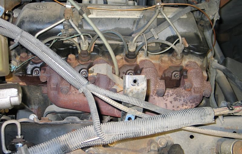

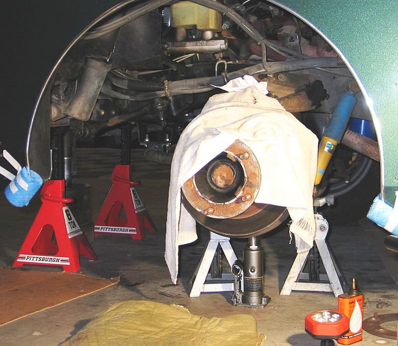

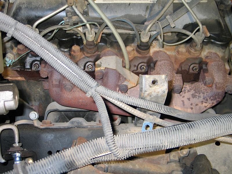

Today I had to cut out the inner fender wall to get to the glow plugs. Been squirting the glow plugs with Blaster on and off this afternoon. Hope to pull them out tomorrow.
Here's three pictures of my project so far!
At 81 I'm done for the day!!

2-8-24 10:30am Got all four out on driver's side- no problem. No signs of any swelling. Calling O'Reilly's to see if they have them in stock. If so- they'll be installed today!
So far so good??

Why did you have to cut out the inner fender on the driver’s side? The driver’s side is the most accessible side. On the passenger side, the job is easier if you pull the inner fender.
ak diesel driver-
Yes, I see the markings. They are 11G. All 4 checked at 1400 plus degrees. Picking up the 8 - 60G's at O'Reileys this afternoon. Once I get these 4 in and button up everything I will go to the other side.
Big T: Something went wrong with the web page. It posted one reply I made twice and not the one above.
Why I cut out the inner fender on the driver side.....it's a motorhome. The motorhome company buys the chassis . They build the motorhome body and then lower the motorhome body down on the chassis... and the engine ends up behind this inner fender well where the glow plugs are. That's why I had to cut it to get to the glow plugs.
Depending on how much you had to cut out, maybe use a rubber mud flap from a big rig with some self tappers and fender washers to make up a inner fender that you can re-cover that area which can later be removed for future work. That will also help protect the engine bay from road and mud debris from the tire.
