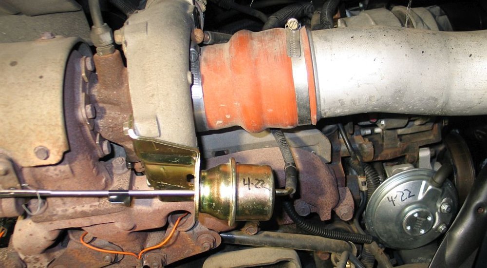

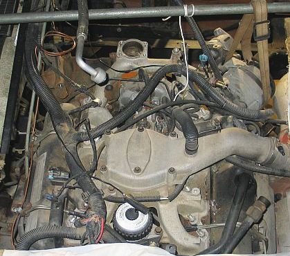

I got a reply from Will L: Love to see pics, especially the engine so we can spot details of different applications. Hopefully we can help ya keep it running good a long time ... Bezzer- .I am working at getting you some pictures Will L.

Here's some pictures you asked for.

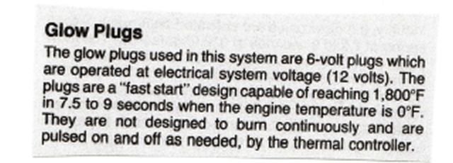

Hi Fellows! I appreciate all the suggestions you have made. I would like to stop calling it "poof" and call it backfire - like a gas engine. After I turn the key to the on position and wait for the glow plug light to go out... .. I immediately start the engine. It only takes 5 seconds to start. Now after 4 of the 5 seconds I hear a backfire out of the exhaust pipe. The engine has only one 3" ID straight pipe. After the engine starts it runs smooth. About 8 seconds later on the passenger side I hear another backfire. If I turn the engine off and wait three minutes it starts right up after the glow plug goes out and there are no backfires anywhere. When underway the motorhome runs just like I picked it up new.
I have attached a copy of my GM motorhome service guide that stated about "Glow Plugs". At 40 degrees outside this is the exact way my engine starts.There is a factory installed electric fuel pump on the passenger side frame rail that starts running when you turn the key on. It is 12V and runs great.
After you turn the engine off....you can also hear the sound of another "possible" fuel pump on the engine that runs for about 10 seconds? What do you think that is running after turning the key off? I do not think I have a fuel problem.

So earlier you stated you only had 6v to the glow plugs. Your manual clearly states you should be getting 12v to them. FWIW using those 6v glow plugs on 12v makes them heat faster and not last as long unless they are the self regulating kind. You need to find out what glow plugs you have and if they are self regulating.
Any other ideas will be appreciated!
