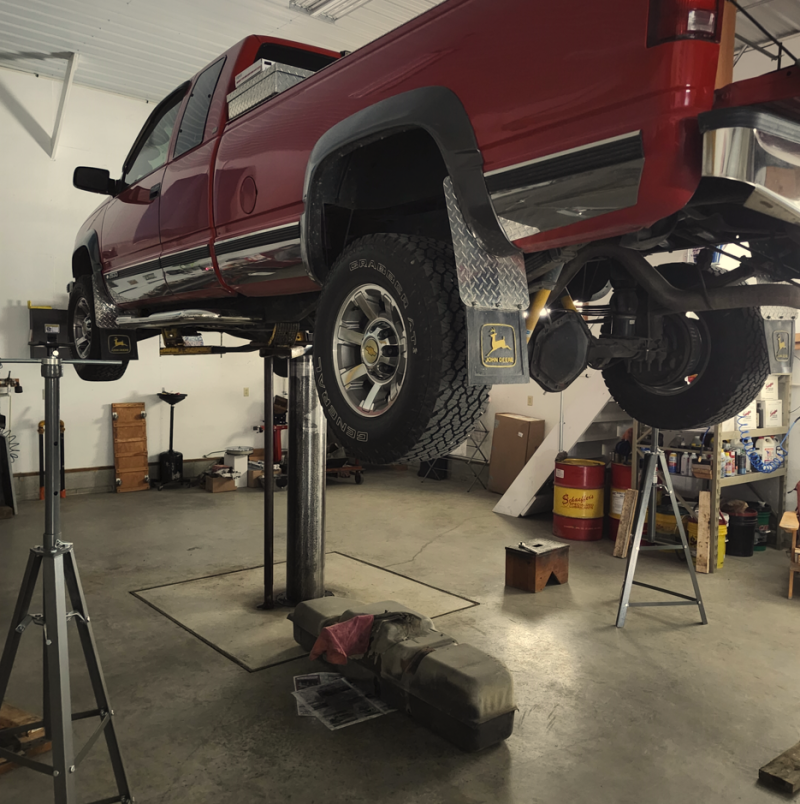

I was going to drop it out on the ground but dad talked me into putting it in the air. We sat the rear down on the stands in the picture and had the front sitting on a piece of wood across two of the arms. That allowed enough space to disconnect the supply and return lines. In case someone needs to do this and wonders what the fittings look like, see below. The bed rails will be getting cleaned up somehow or at least get a thorough douche job with Fluid Film. Hard to believe what the tank hides.
