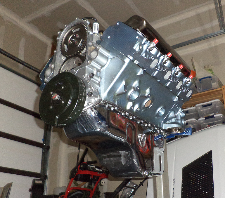

Spring 2013. New "ULSD" IP, rebuilt motor, High Output injectors, Air Dog DF-165 pump (15 PSI which, IMHO and Stan's. opinion, is too much).

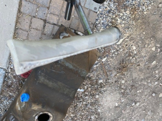

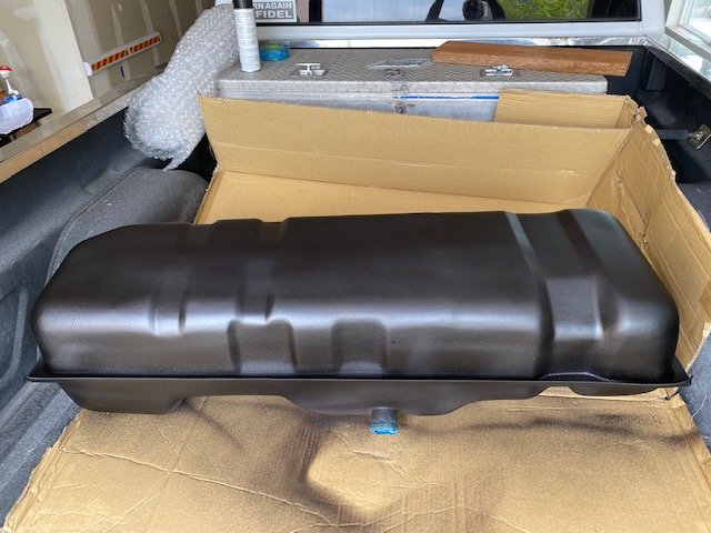

New Fuel Tank (arrived today and currently waiting for undercoating to dry).

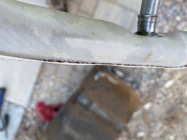

New Tank Sock on the shelf.

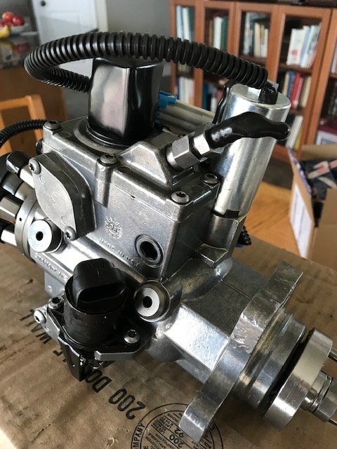

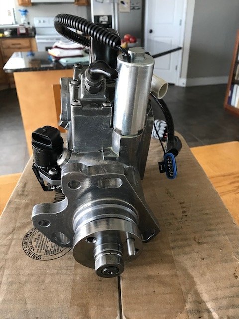

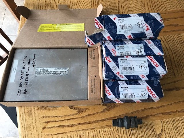

New IP on the way.
New set of Bosch injectors on the way.

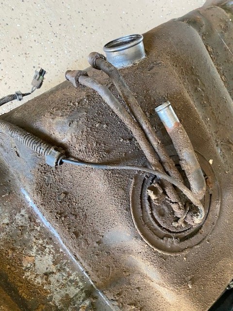

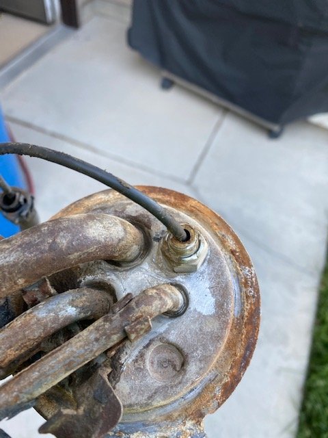

Blow lines out going back to fuel tank, fully drain the tank.
Replace tank and sock (will be interesting to see what that sock looks like).

Replace IP.
