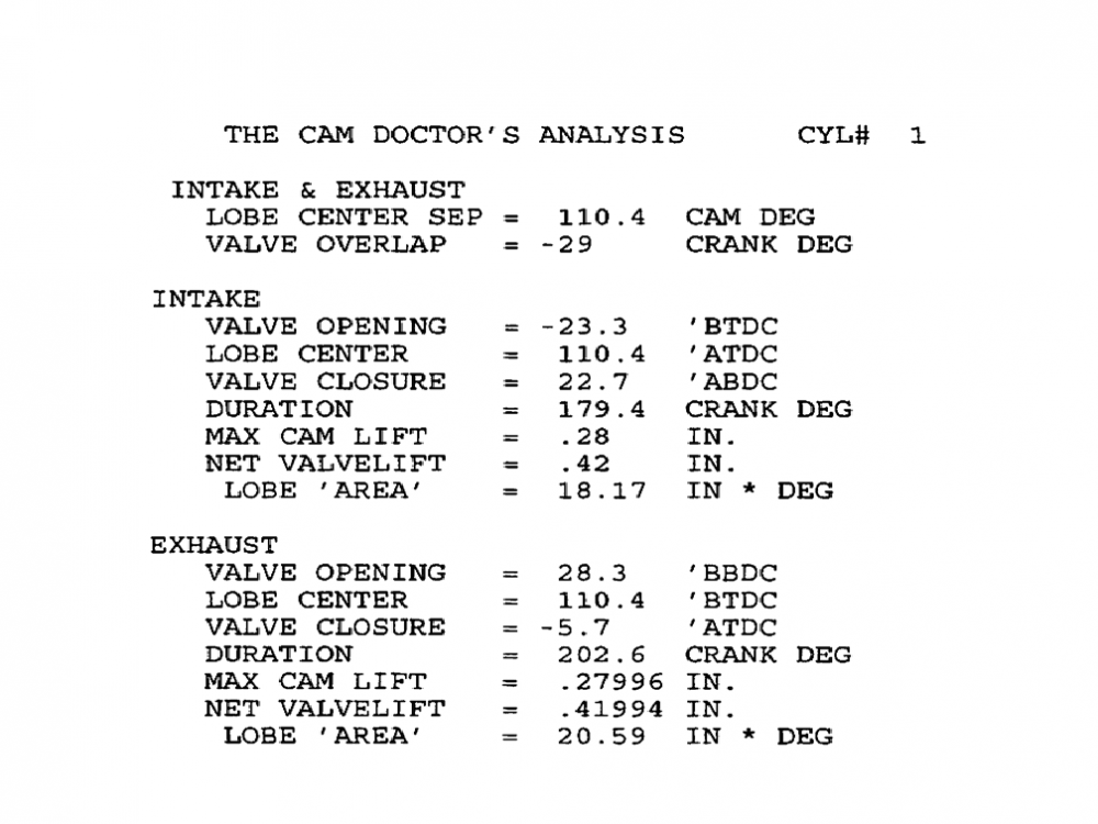

To check or degree a cam you MUST have specs or a cam card for said cam, if not why waste the time, you still won't know anything. I have posted the specs before but I'll do it again, maybe it can get moved to the fact section..
Our cams can be moved + or - 4* depending on application and desired performance, that needs research if you don't know how a cam reacts to changes. 99% of the time line up dots and hope for the best, it's that 1% that will bite you...
ALL SPECS ARE MEASURED @ .050lift
