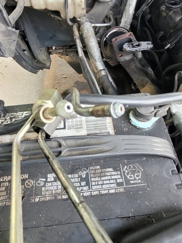

Got the leaky line out. Take a look at the new next to the old in the picture. I actually replaced (had my son replace) all the lines on the turbo side so we shouldn't have a leak on those for a few years at least.

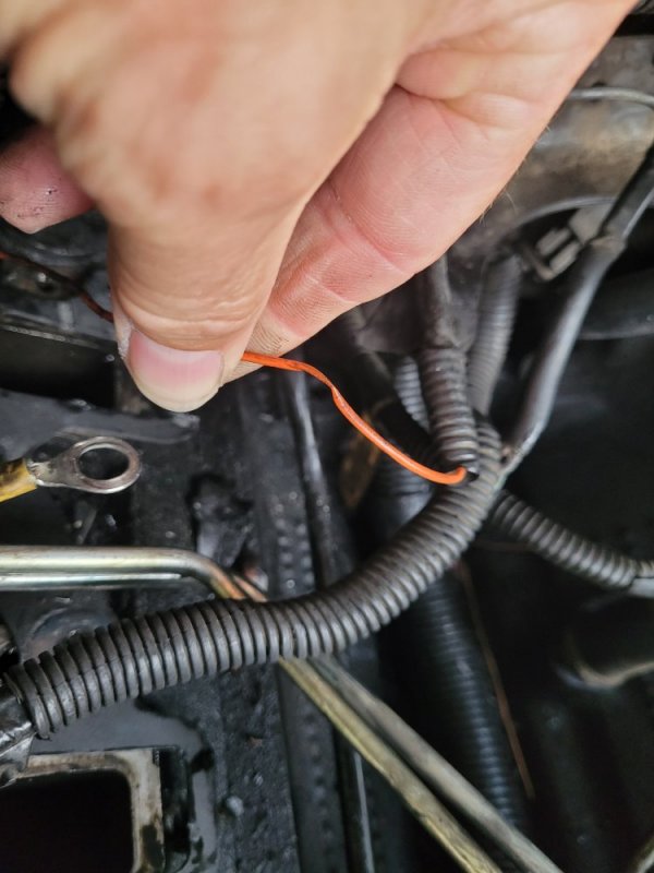

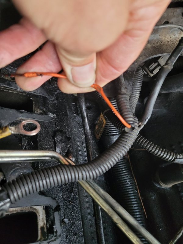

I think/hope I found the culprit. I just finished breakfast (not that you guy's care) and psyching myself out to do more tedious work trying to track it down. Doing a visual inspection I noticed that there is a red wire pinched between the block and intake on the back passenger side. I tried telling my son everything to watch out for and didn't tell him not to pinch any wires. :banghead:
Check out the pictures. There are 2 flat spots in the wire where it crossed over the intake hole. I checked for other burnt and open wires but can't find any. That has to be the cause but I can't find where it burned.

Glow plug is most likely ok. Tape the bare spot on the wire, hook everything back up, have someone turn on the key, stand and watch. If nothing bad happens, good to go, other than that pesky prestone leak and replacing a bad GP wire.
No, it isn’t just grounding out as a concern. When the wire is smashed flat like that, it can break some of the wires inside the insulation. Especially because he heard an electrical pop. What happens is the amount of wires still left in good condition is not enough to carry the load. So now it’s like having too small a wire for something and they overheat and burn up starting inside the insulation even without it shorting out again. When the wire fails it gets crazy hot and melts out of the insulation, can start fire, etc.

It's alive. I got it done yesterday just as the started. I cut out the flat spot section and spliced in a 16 guage wire a little longer than what I took out so I have a little more slack to work with. I also replaced all the lines on turbo side so I shouldn't have one of those go bad at time soon and need too take off the turbo again.
