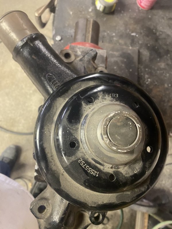

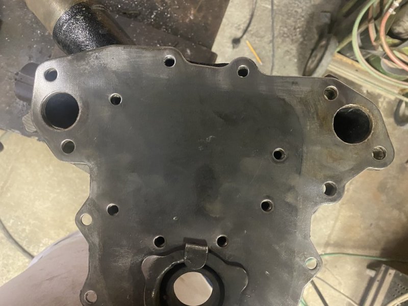

So would there need to be a modified cross over at the back of the heads ?That is all owned by GM. They didn’t even mention they had it at first. When the engineers showed up and saw what I did, cutting the sides out of blocks- they made a call and it shipped here within about a week. When over, they took it all. Sadly probably all destroyed long ago.
2 sealed flow meters and a modified crossover to accept them is all that needed if someone wanted to make it.
It would be nice to have an engine laying around to do some testing with.
I suppose if a person could rig up a pressure gauge and also some clear connector hose they might be able to get a look at air bubbles created by cavatation.
Would need to test between the original coolant pump and the flow cooler unit.
If someone has an old block and wants to invest a little time and money into testing these pumps I would be willing to ship this one.
