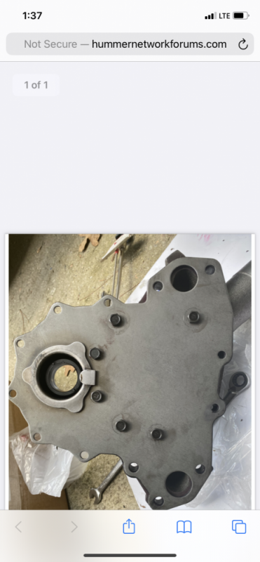

I’m getting ready to get the 2000 K3500 into the garage to install the new cooling system uprated components.
In @Will L. s thread, a pic of the pump and the backing plate shows that the ports on one side are not matched.
Just looking for ideas and opinions if it would be a good idea to use the die grinder and remove minimal material until the ports match between the plate and the pump.

With the information that @Will L. has supplied, now I am wondering if I should install the flow kooler pump or just leave well enough alone and stick with the balanced flow OE style pump that I recently purchased from NAPA.

@Will L. if that clear poly 6.5 engine block would happen to still be a available and You would want to do some testing, i would be happy to donate this coolant pump to the cause.
It would be mighty interesting to see how one of these pumps would do as far as flow and cavitation. I would even be willing to pay the postage on it.
