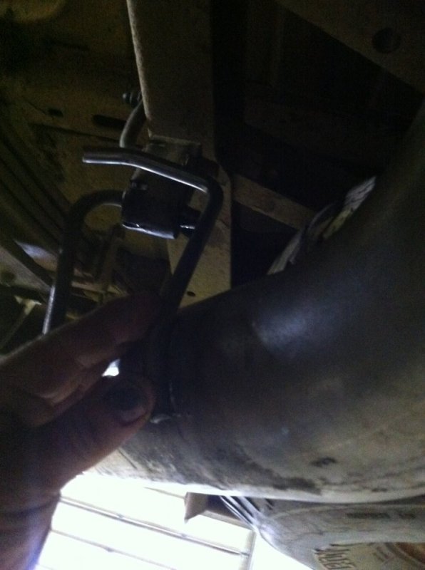

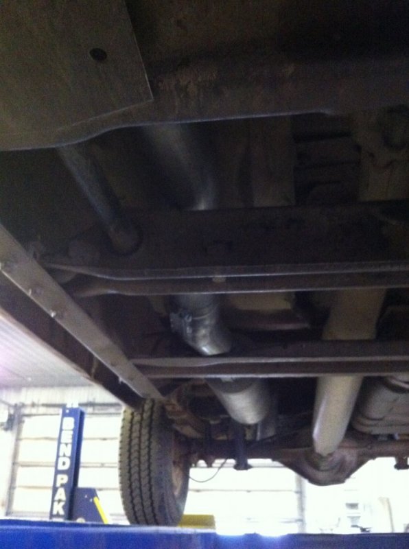

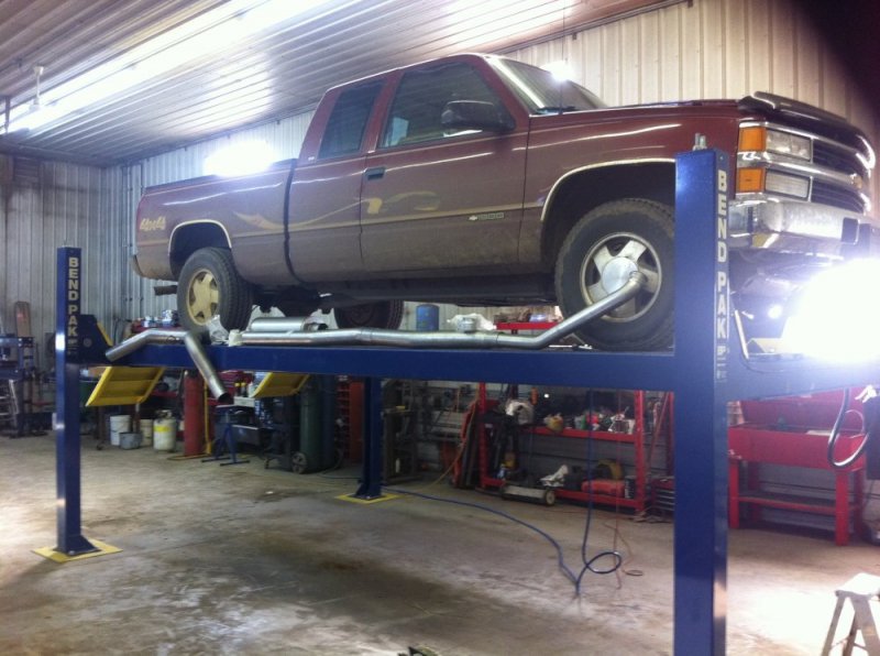

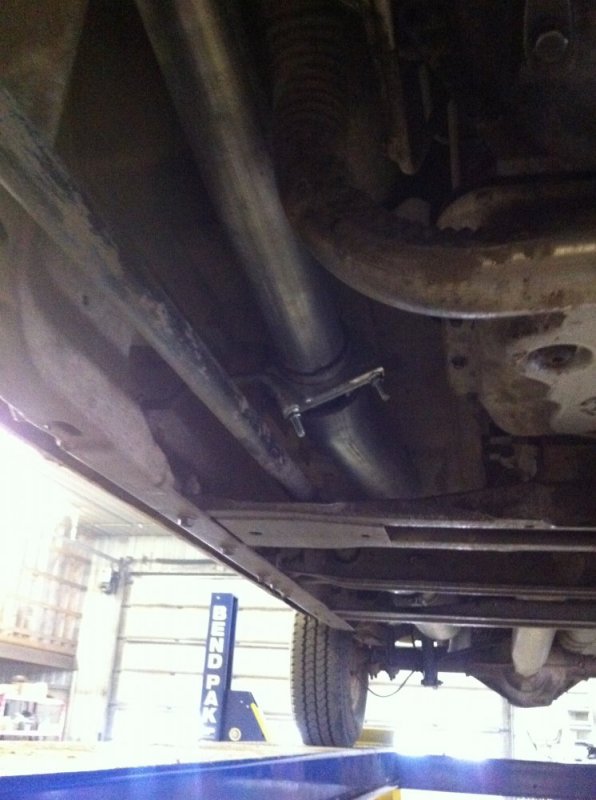

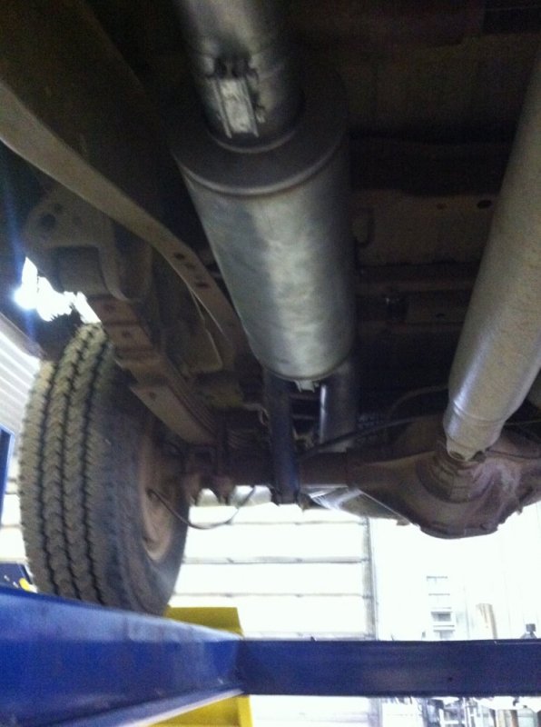

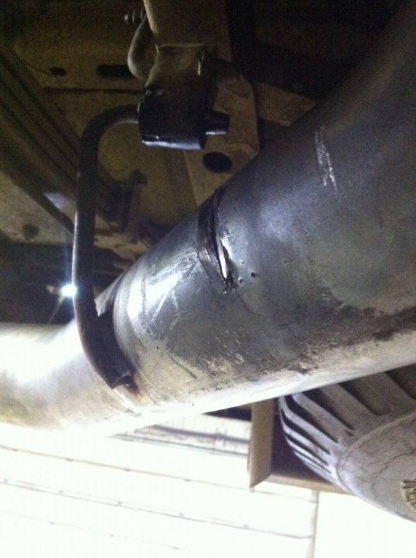

I recently purchased the 4" Flo Pro Exh. for my 98. It is quieter than the Hearthrob on my 95, which I like. It was harder to install, hanger on the tail pipe was cheap and in the wrong spot. The tail pipe took some tweaking, it wasn't bent quite right. It could have been bent a bit more to the frame rail. The spare had to be shifted to the drivers side. It came with hangers but I cut the old hangers off and reused them, they have the little knob on the end to keep them from coming out of the rubber isolators.
IMG_0894.JPG IMG_0895.JPG IMG_0896.JPG IMG_0897.JPG IMG_0899.JPG IMG_0900.JPG
Now that it is on I like it, install wasn't so friendly.

Looking back, in all fairness. When I got the Hearttrob exh, it came with the same type of hangers. I didn't try to use them, I went right to reusing the original hangers. I wasn't as lazy then.

The band clamps are nice but don't hold it together like one pipe inside the other. It wasn't hard, I just had more trouble than the other.
