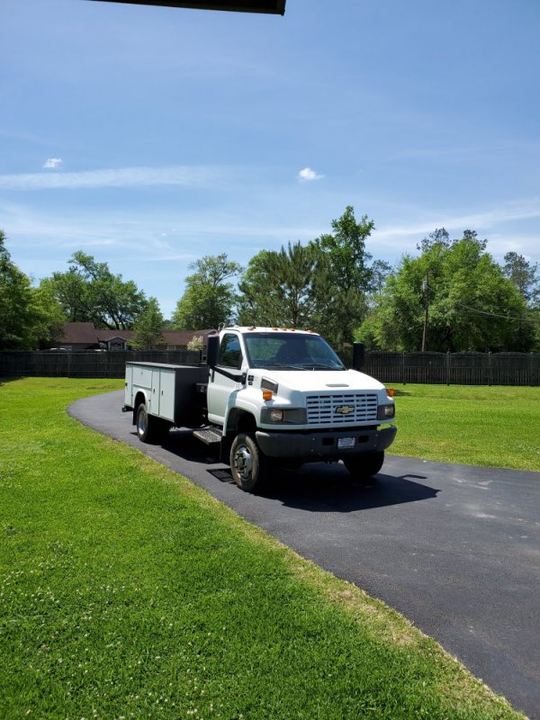

I used to build flatbeds (owned truck equipment shop) if you can space the bed up off the frame, you could fit slide out ramps like are used on uhaul/ penske moving trucks.
Either do one on either side of the frame, Make sure to plan out wheel clearance. Or stack 2 together and stow them over center of frame.
We used to do extension ladder stowage there for construction trucks.
I agree with Forest, if you can afford a rollback set up they become quite versatile.

That looks good. thanks for input

What are your funds like? Have you considered doing a rollback type setup where you can load on the ground, and than load the entire bed on in one move?
That was my original thought. I priced one installed for 31 thou. Little more than I wanted to spend.
You have any recommendations for any brand?

Or for the amount of weight that you are looking at - what about looking at a round baler option, and modifying it to your use?
Or - my buddy purchased an old chevy pickup truck that has a winch that pulls a flat bed on and off the rear frame - think trucks that load the dumpsters on rails and secure it to the frame.
2 other options that might work just as well for less?

What engine is in Your Kodiak ? I used to work on a lot of those trucks, all with air brakes and the 8.3 Detroit diesel.
