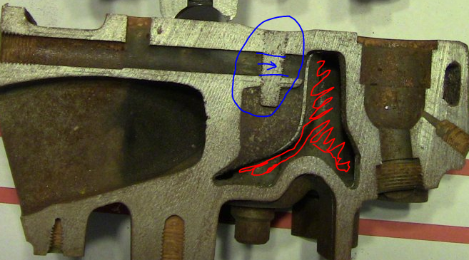

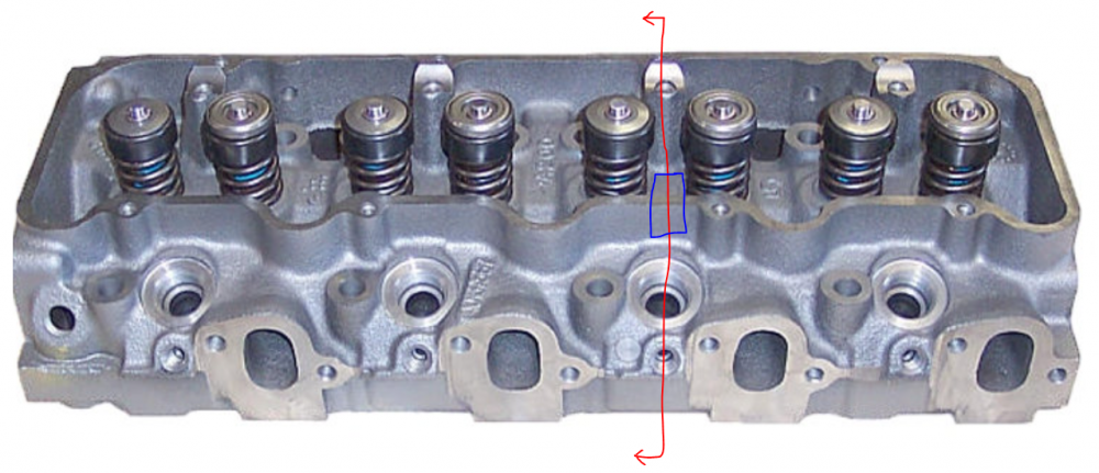

Is the cutaway right through here?
If a guy wants to use P400 heads, without the plumbing you added (or cannot due to using a factory intake setup), does the coolant move through the head in this area?They are for coolant flow between the valves and when plumbed in will lead to the water crossover. If yoy look at my past pics of a head cut apart, that passage is a dead hole and air is trapped water will sit, this will allow flow and all the air to be purged from the system...
