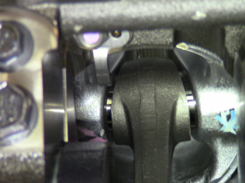

The connecting rods are fracture broke unlike the GEP rods

There are a few other things as well, rod & main bearings have different part #, me thinks they are a different makeup... pistons, rods, crank,oil pump is different, the bypass spring, because the P400 has much different oil passages, and other significant things I don't make public...
