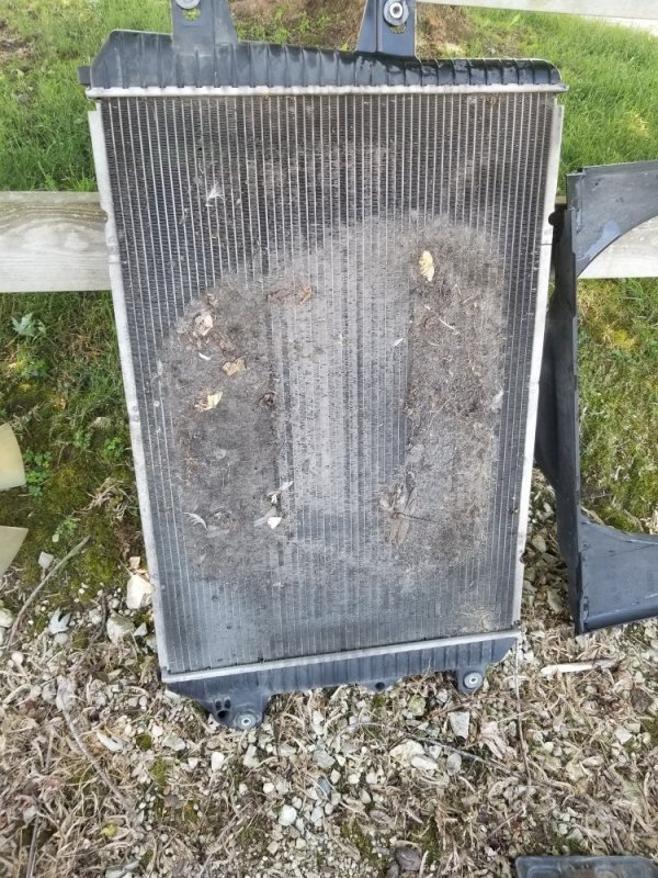

Getting set to clean the stack next week install all new hoses and I suppose it's about time to put in a new fan clutch. Is the Hayden 2886 still the best choice?
The fan and clutch he used is for the 21" fan like was used on 01-05 trucks and vans. 06-10 trucks used I believe a 23" fan. There is no evc and fan combo to work for a 06-10 truck that I've seen.Either that or do the electric fan clutch like AK Diesel Driver did.
Be able to set the temp it comes on, and have a manual engagement over ride if you want.
LBZ, one tough engine......That's not good. I'm surprised you didn't have problems with the engine warming up with it that bad.
It was getting hotter than normal but besides the AC issue I was seeing trans temps tickling 190. With Transynd I wasn't real concerned about that but I knew it needs a clean out.That's not good. I'm surprised you didn't have problems with the engine warming up with it that bad.
