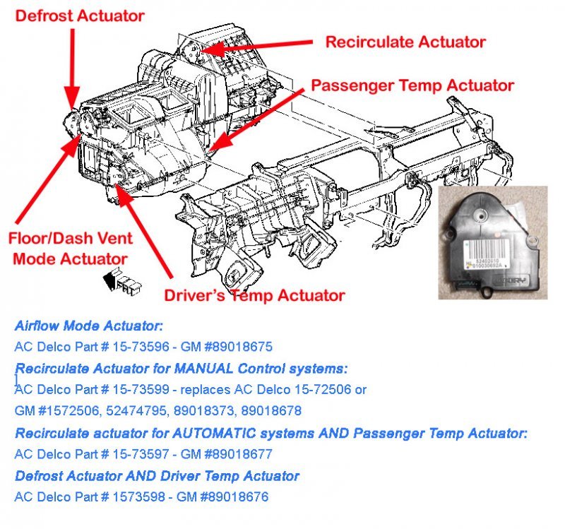

No codes. I'll try removing and cleaning the actuator, I have an exploded diagram of the location of all actuators. I've already replaced the actuator for front vent/floor and the rear vent/floor. The rear one has pissed me off because the new one is now broken. Does the whole clicking thing when first start up because it breaks the shaft on the actuator during the start up "diagnostic". When I was installing that one I was testing the old one first and couldn't believe the incredible amount of torque that it was sending. I physically couldn't stop the arm to trick it into thinking it had reached the end of a cycle. It would only slip on the shaft when I reinstalled it and the blend door stopped it, I wasn't strong enough to make it slip even with tools. No wonder these things keep breaking the plastic teeth etc. I've been seriously thinking of putting a resistor in at the plug for the back one and putting the original actuator back in. It didn't have any broken teeth, just would spin on the shaft under extreme high torque. That freaking blend door isn't that hard to move, it only needs a small fraction of the torque that it sends.

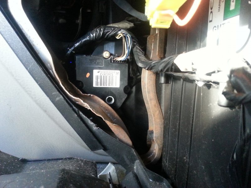

I removed the temp actuator, took it apart, and cleaned it up. I didn't see anything really wrong with it so I'm not holding my breath. That actuator was a bugger to get out since it sits directly behind a metal brace of the dash framework. Easy to get to/see, just the stupid brace in the way. Had to bend the brace out of the way with channel locks, not very easy.

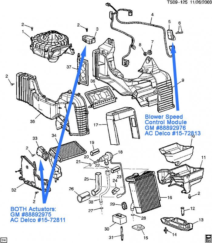

2 possibilities for fan speed. Underhood fuse #35 40 amp, OR more than likely the blower resistor is bad, they are notorious for going out. It's an easy replacement job, under the glove box.

This is the location of the passenger temperature control motor. They didn't think ahead too much on location, you have to bend the framework to get it out. I used a pair of channel locks, and a C clamp to bend it. Bit of a pain, took about 45 minutes to do.
