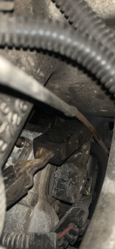

I started thinking about what you said about the PMD and all and remembered that when I relocated it, the old one that’s still mounted on the IP was working that I had just wanted to relocate it. So I decided to reconnect the one mounted on the pump to see if it acted any different! Boy did it!! But In a bad way When I started it up it ran like crap and bad misfired and bucking while trying to idle. So I swapped the connection back to the one I relocated. Started it up and still missing and running really crappy! I knew I was moving wires around trying to connect the IP mounted PMD so while it was running I started poking at the harness around the IP. Low n behold I touched the harness going to the OS that seems to have some sort of small square black box before going into the engine harness and it straightened out and ran fine. I’m not sure what that black box is that the wires go in one side and out the other the to the OS connector but while playing with it tapping with a screwdriver it misfired a few times! I guess I need to replace the harness or at least take it all apart and look for broken or corroded wires and connections. I tried to attach a photo of the little box maybe y’all know what this is.

From what I can see the is the OS filter. You don't need it throw it away as far as you can!
a noise filter! is this for the radio? I would have never thought that, I was thinking it was some kind of diode or something to prevent voltage backfeed! I will definitely remove it tomorrow after work.

Well, I am happy to say that I think the problem was found! After removing the OS filter, I went out doordashing with the wife for a solid 5 hours ( even had the AC running to keep her comfortable ) and the truck never skipped a beat. not one single misfire all afternoon .
