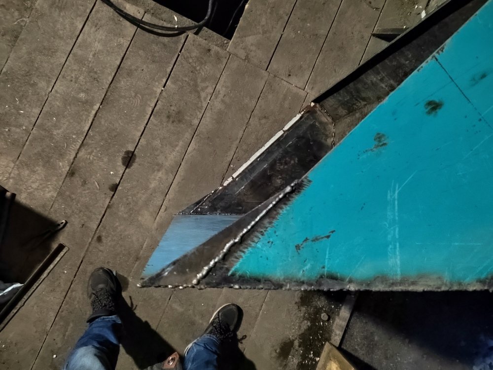

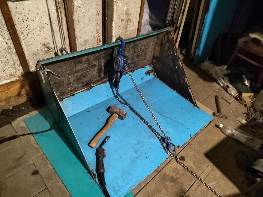

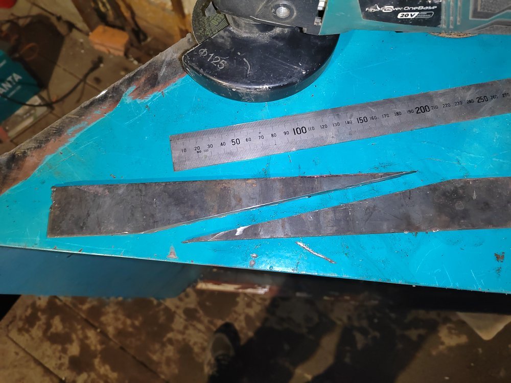

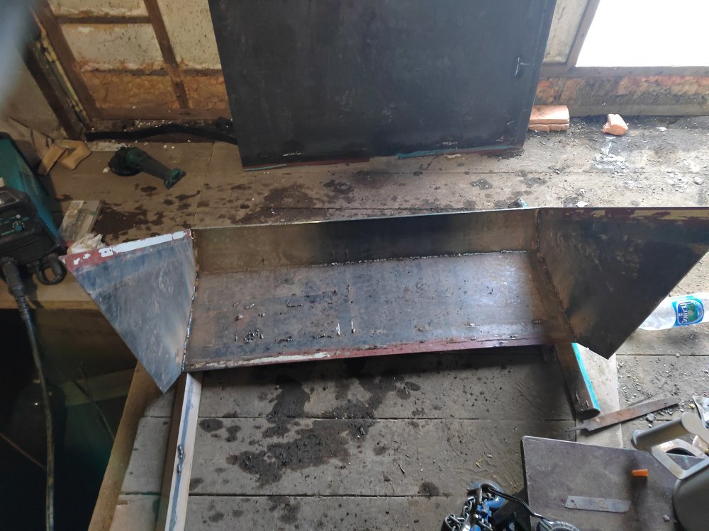

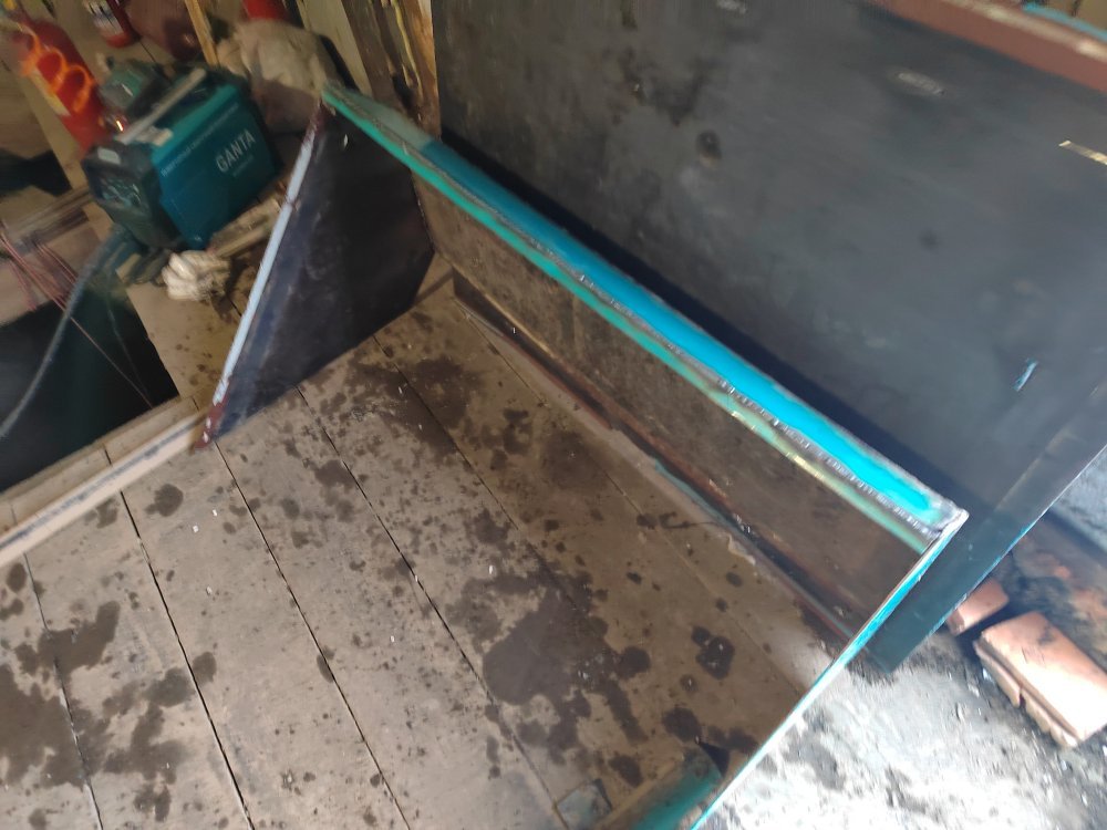

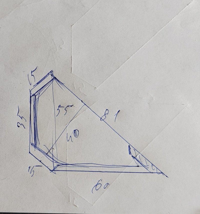

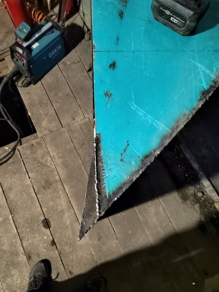

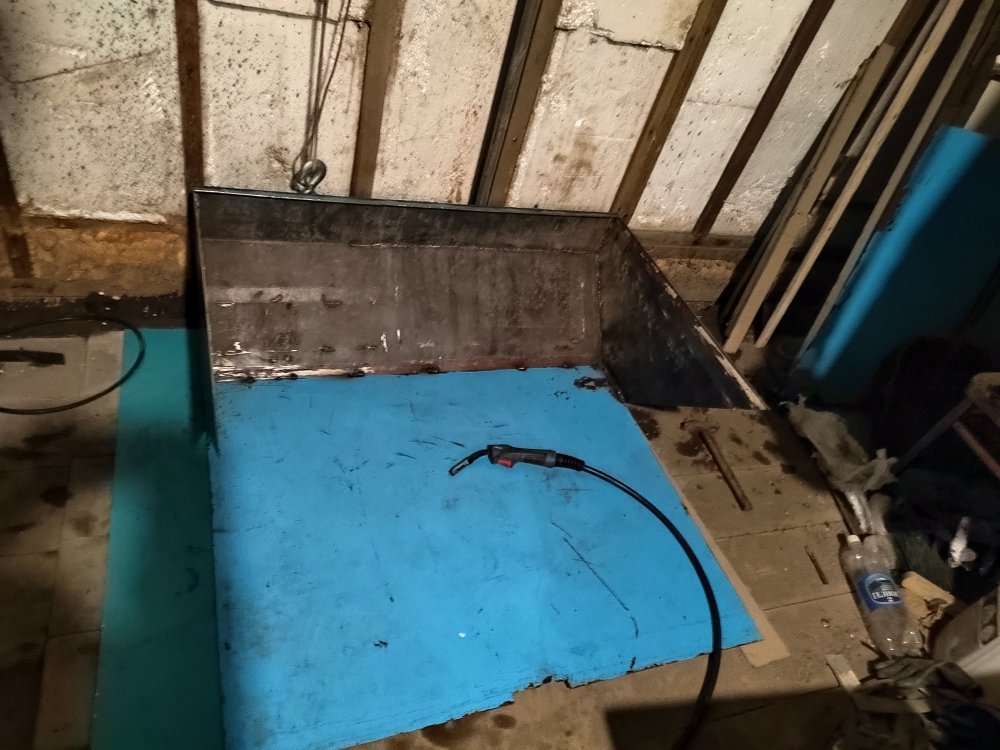

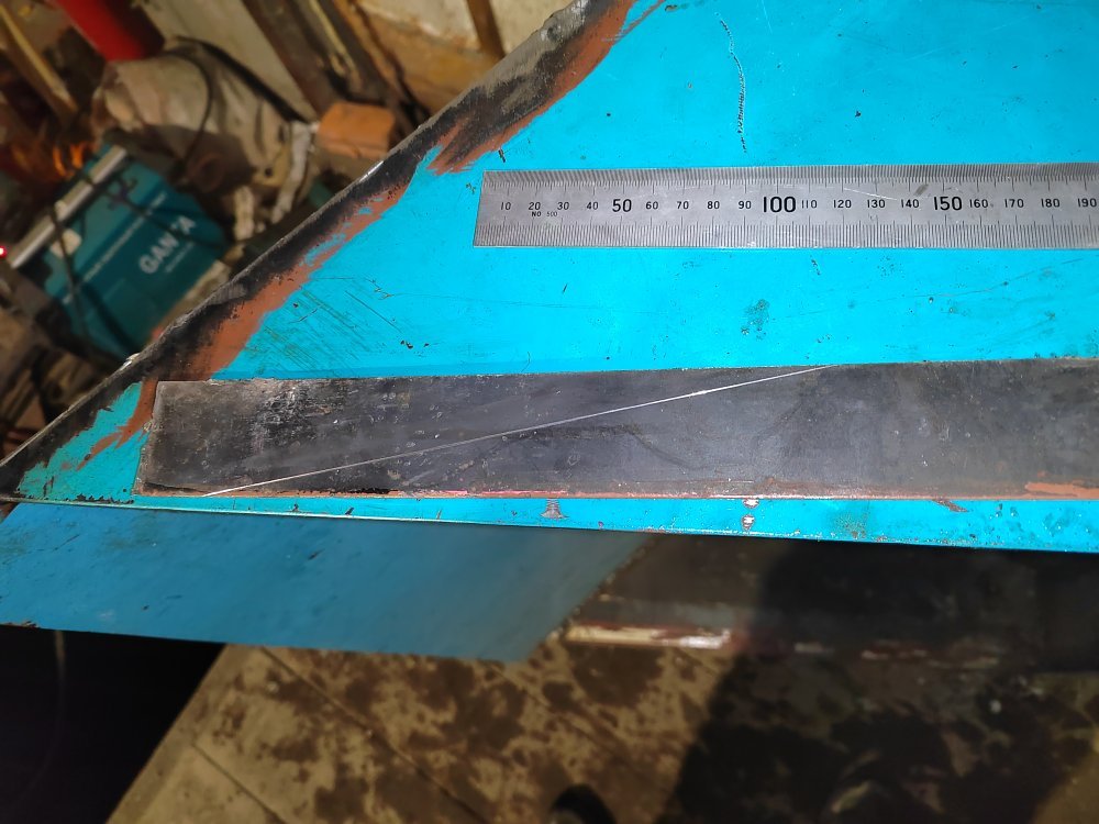

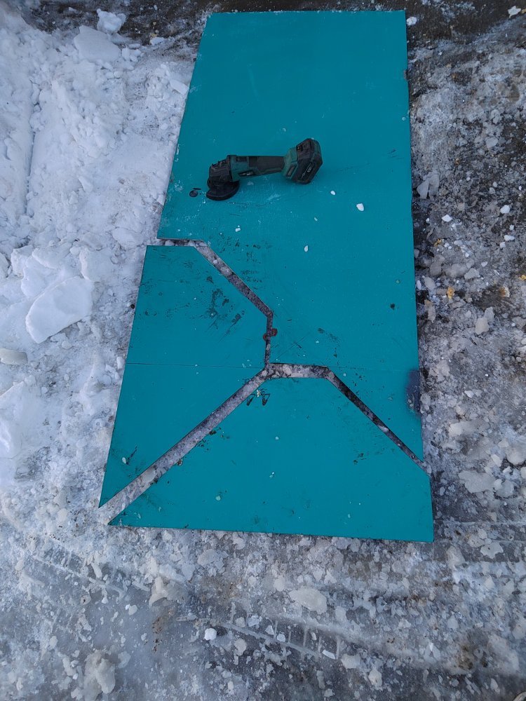

I started making a bucket for the rear linkage for my Iseki 177. I bought iron doors on Craigslist with a thickness of 3mm (1/8") and 4mm (5/32"). the lower part is made of 4mm metal. Due to the faceted shape, a rigid structure was obtained.
(Size in centimeters)
