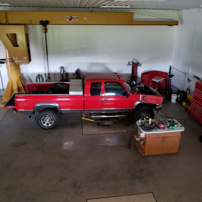

I don't have quite the rundown some have done, but have been taking pictures so we remember where wires are, etc. The bed is full of parts. It's getting closer, but there's still a long way to go.
That's a helluva engine hoist you have there.
Now I'm completely ashamed of my tent.
