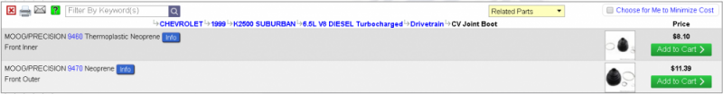

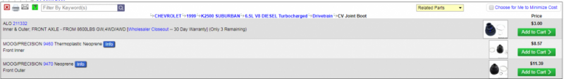

Called Rockford and they did not have all the parts for the 8600 GVW and concluded that they must have only sold for the 7200 GVW. Now I'm even more confused. Rockauto shows different inner and outer boots by MOOG, one of which is "thermoplastic neoprene" and the other is just neoprene. There is a separate listing for ALO indicating the same boot for inner and outer on the 8600.
I punted on the order from Rockford as I need to check the GVW on both the Suburbans.

Checked the vehicle tag and it's 8600 GVWR. Checked the boots and inner and outer look the same.
