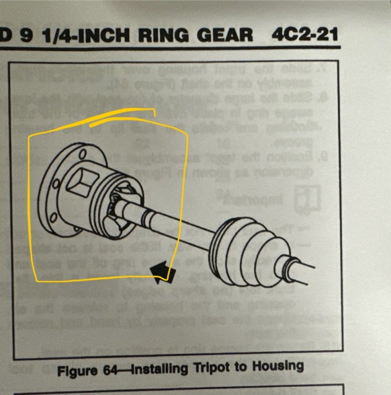

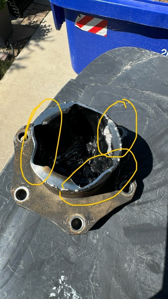

Fingers uncrossed. Differential failed...axle was pulled out of the passenger side like what initially started the differential dance last October.

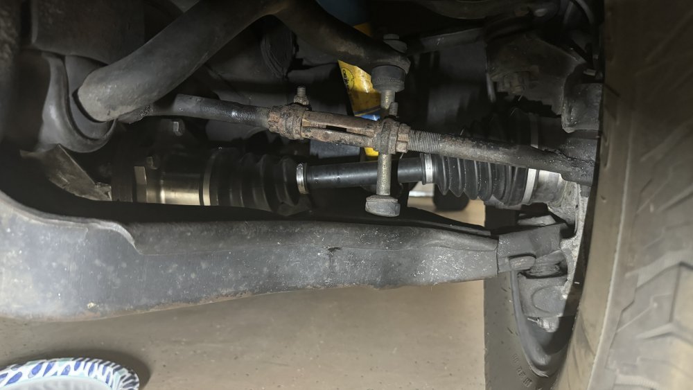

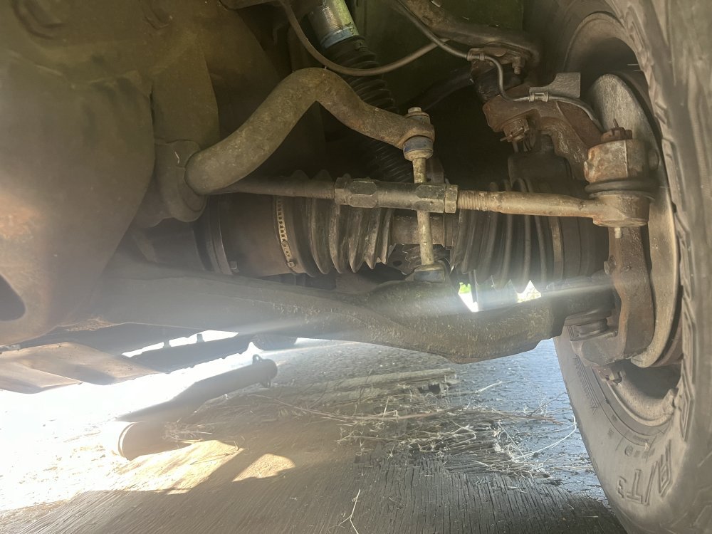

I decided to take it for a test run in 4x4 to see about the new diff and while coming out of an 8" deep dip and over a 6" rock on the other side of it...BUSTED another differential in the same place as the last one.

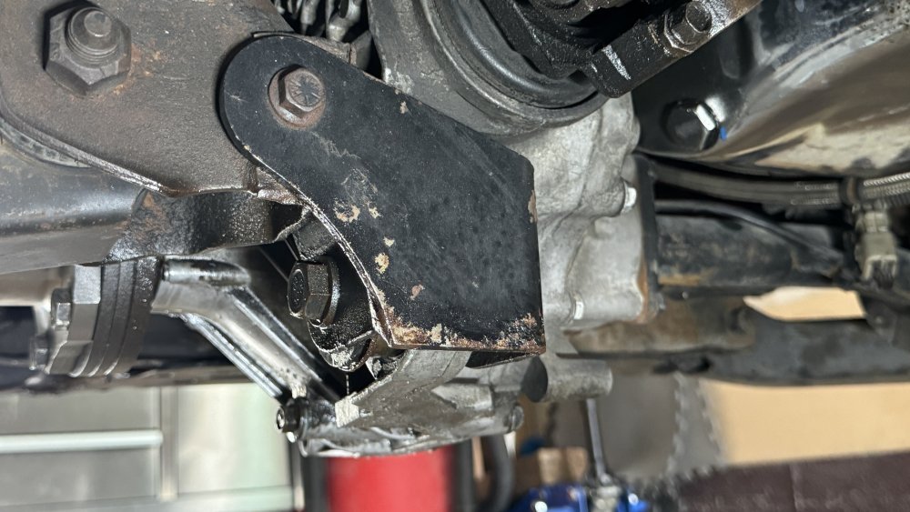

Figure it has more to do with turning down the 3" torsion bar key lift kit to save tie rods and idler arm etc. The extended upper control arms are still in place as are the longer shocks but the front is turned all the way down and the cv's are level. Even a stock height K1500 has 30 degrees of angle on the half shafts... guess I screwed myself...what else is new.
