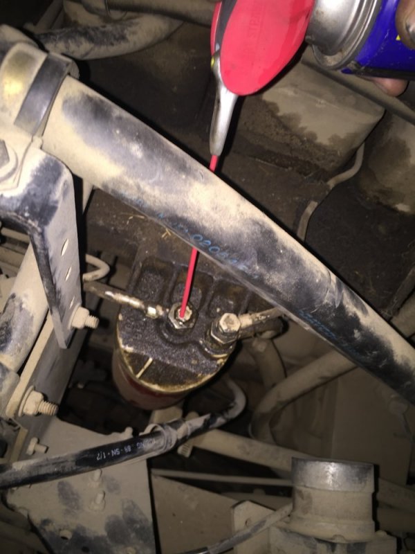

Before: you could turn key on, pull solenoid up with finger and it would hold. Then start engine and tour the world. Just had to pull the solenoid in hy hand. They bought it like this a few years ago and used it a few times. Now divorced, time to sell the rv, so wanting to fix the issue.
It has sat for a year.
So the solenoid was not pulling in, but would hold with key on. Nephew started to pull solenoid out with intent to replace. Saw an empty solenoid box in the storage area, and it looked new...
So I had him replace the relay that feeds the solenoid and reinstall the solenoid. Now that works, but...
No fuel to injectors though. Intersting enough no glow grid for heating air. Give a shot of wd40 and almost starts, with now gid, i give a little shot of starting fluid. It wants to run, but no fuel. I remove this screw in picture (wd40 straw as pointer), and pressurize tank. Fuel comes up and tighten screw. Figure air in line from it bleeding off over the time parked, crack injector nuts- can't get any fuel. That screw is onnthe line that feeds directly to injection pump btw.
Scratching my head- any ideas?
That's the bleeder screw. You need to remove that, follow the fuel line from it down and towards the bellhousing until you find the fuel pump. On the end of the pump will be a button, you pump it to pump fuel to the engine. What normally happens is the seal on that primer in the end of the lift pump goes bad, and allows it to leak. Once you get fuel out of the bleeder port, put the screw back in, and pump it another 30-50 pumps until you can hear a good steady stream of fuel squeeking through the return at the injection pump. Then crack open as many lines as you can, and start bleeding there. That is a high presdure injection system, and you WILL burn up the starter trying to start it with air in the system as it will take forever for it to build enough pressure with air in the lines to pish fuel through them.
As to the solenoid, it is a 3 wire, double action solenoid. 1 wire is a ground, 1 is a hold, and 1 is a pull. Most are wired so 1 wire is hot via a 30 amp relay anytime the key is on. This circuit is just to hold the solenoid closed, and does not have any real pull to it. Then the other circuit is activated via a 70 amp relay with either the starter, or a seperate relay that only energizes as power on(a relay that energizes itself, it sends out a very brief sugnal which is just enough to trigger the solenoid to pull closed). The pull side is a very high current side, and can only be powered for brief periods, otherwise solenoid failure WILL occur. Also I like to manually adjust them so when the solenoid is closed, the fuel cutoff is pulled, but not tight. If the solenoid is held even slightly not fully closed, it will ALSO fail in a short amount of time(I learned this one the hard way). So I always manually adjusted them to be certain it was right.
OK thanks. I knew there should be a primer pump some where, but didn't see it. Have to search again, maybe it is hiding down by that sweet little Allison trans. I removed the screw and had the nephew watching for fuel. I charged the fuel tank with 15 psi of air, and when he started getting fuel I stopped and had him screw in the bleeder screw 1/2 way. I charged again and told him tighten when air surges stopped. he called out and I dropped pressure. Then cranked 4-5 times. obviously not air free I walked away before anything could get tore up. then talking to him last night about it, he described it as if air was not done purging to the screw!! kids.

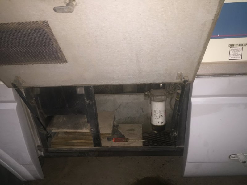

Ok. Today I finally got back to it. Like most people that post a thread for help, we did something I forgot to mention. There is a nice fuel water seperator in one of the underneath compartments. I had the nephew crack the screw to drain any water that may be in there before we started.
Sigh...
No, he didn’t get it tightened. We were sucking air the whole time. Tightened it up.

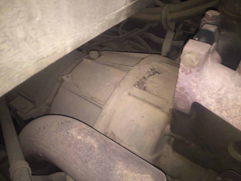

The primer pump was right where @THEFERMANATOR said it would be. Cranked the engines for an entire 4 seconds and VROOM.
