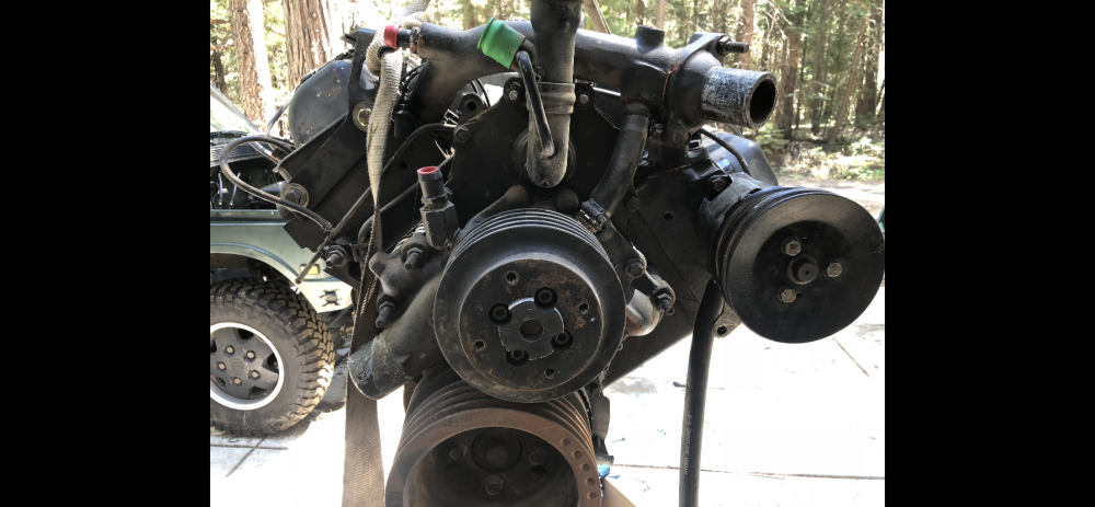

Just because the one or two you may currently own doesn’t have it doesn’t mean they don’t exist. None of the 6.2 /6.5 generators I saw ever had a rubber pulley. And there is a big customer that bought many- the US Military. What- you don’t see many hmmwv engines where you are- ok. Here is a picture for you. Please not the crankshaft breaking in the hmmwvs are not even a known issue because it happens so rare.
