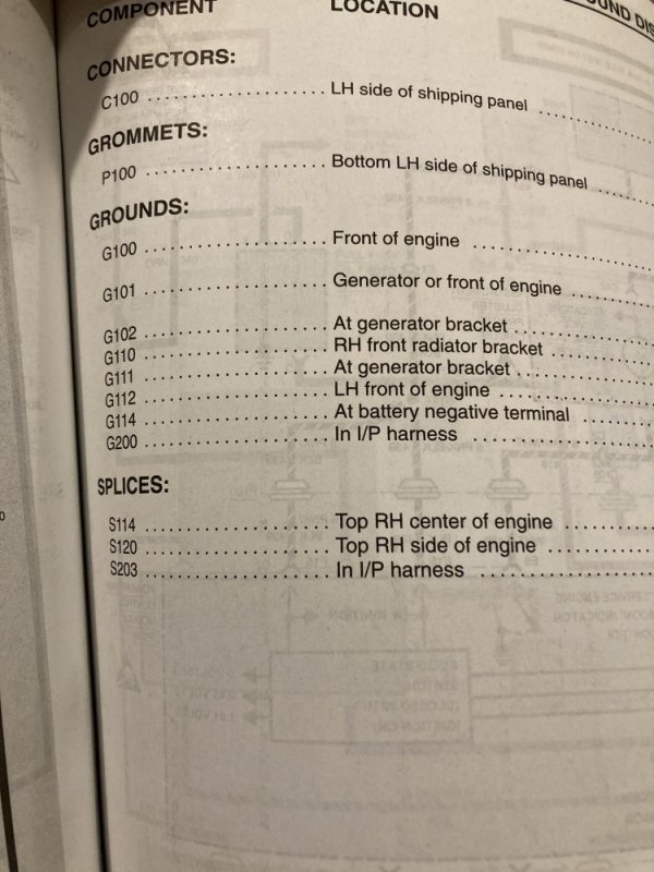

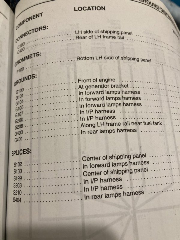

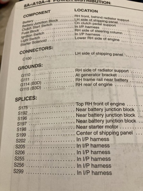

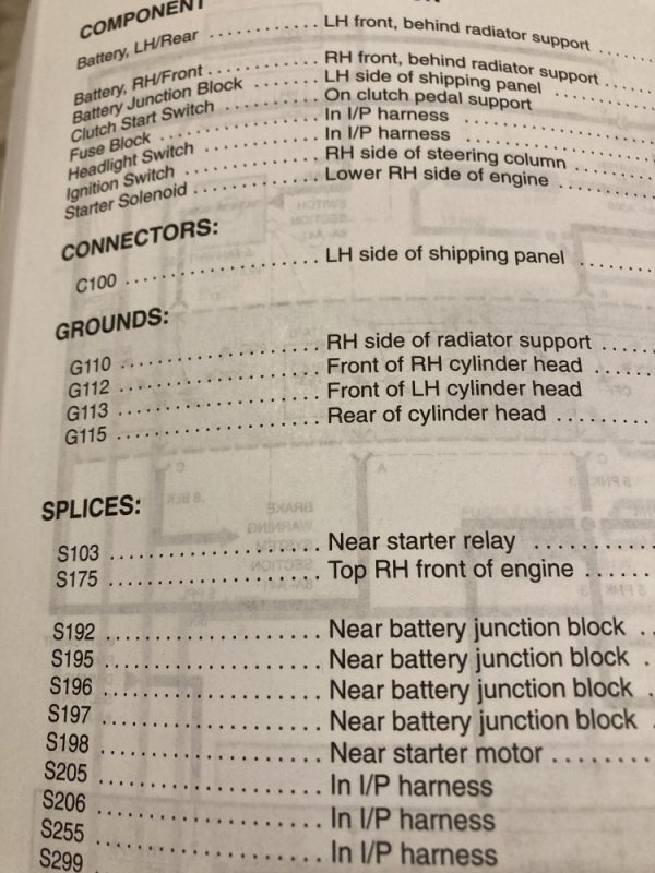

Maybe someone on here can post a picture of the grounds at the back of the passenger side head. It'll be dark when I get home. The negative battery cables should connect to the engine up front.
Ill try and remember to look in the 95 motorhome service manual and post some pictures of the chassis grounds when I get home.
Being that it is a motorhome all bets are off on ground locations. Might want to consider a service manual to help with the locations. I think Jaryd has some for sale.
Yup. The last four rv’s that i saw with this engine in it- all were different from normal trucks and different from each other. This is unhappy information, but you are simply going to need an original manual for that rv, or trace each one down by hand. If you go through that mess, I suggest making your own diagram because there will be a day in the future it is needed.

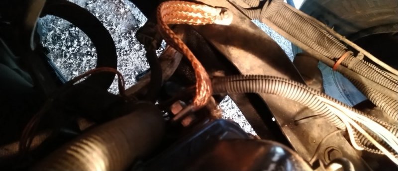

This is about all I could come up with when it comes to the ground locations. There is no diagram in the manuals showing locations that I could find
