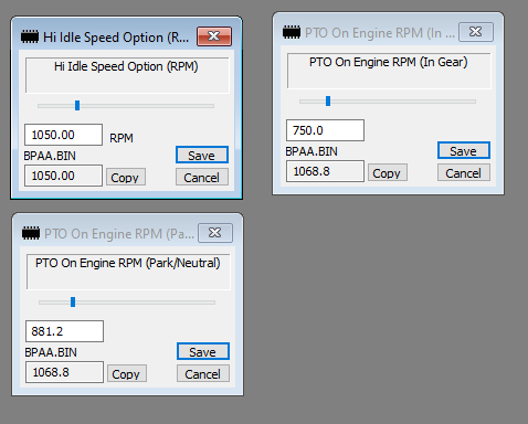

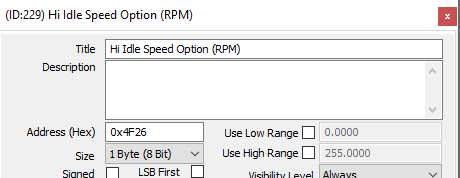

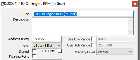

I just found a new setting in the bin file for high idle. at first I thought there were two, but now I found another. I know on the OBD2 systems there is three settings and from what I have been told there is only 1 for OBD1. I just found 3 in the OBD1 prom chip. need to verify this, I also don't know if the labels on the "PTO" in gear and in park are correct since the XDF was hand made by someone.
it is possible that there may be another pin or two on the PCM that can be wired in to a switch to have all three options. I will need to study that as well. here is a screenshot with their hex offset locations in the bin file. note: I have changed two of them so that I can test my high idle switch and see what RPM it goes to.
