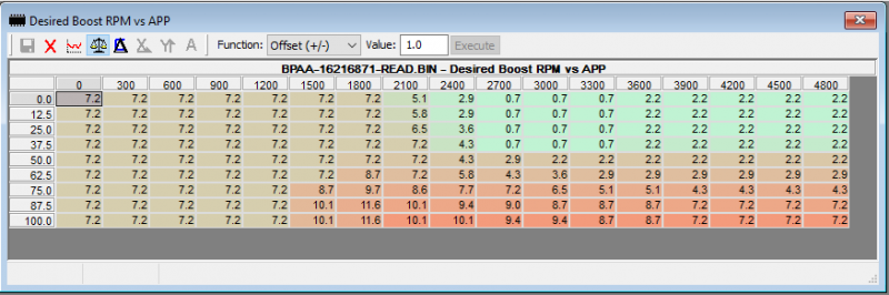

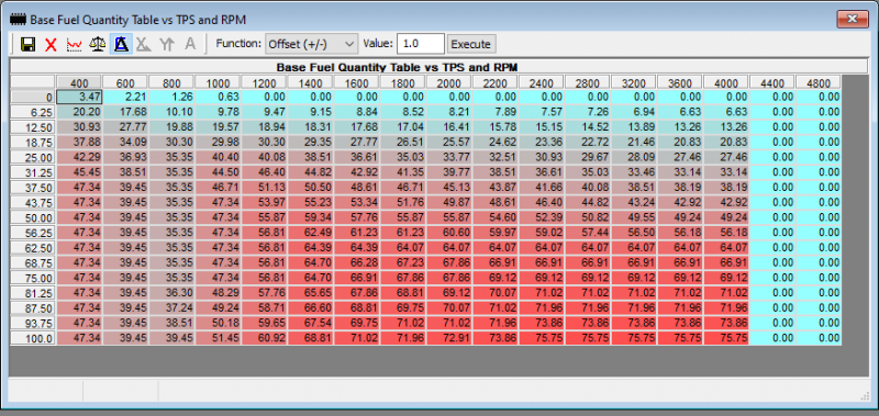

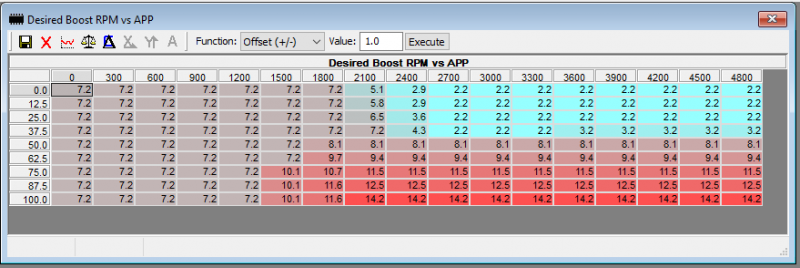

Hey Guys, I haven't updated this thread is a bit so I thought it deserved an update. I have been playing with a DIY tune on my truck for the past few weeks. so far i have noticed some improvements in different areas. I have changed the boost table to allow higher max boost and added a little more fuel for over 50% throttle. things I have notice is when on a flat road accelerating up to speed normally (not dogging it) I am realizing I am up to 65mph quite quickly and a lot of times I don't realize or feel it! when I accelerate hard like on an incline I have seen boost pressures up to almost 15 allowing the PCM to control the boost. I did however see only one time where I was already going about 40mph and for whatever reason decided to see what it would do and stomped the pedal... the truck downshifted and took off lickedy split. I only held it for a few seconds until I saw my boost gauge showing 18 almost 19 psi. as soon as I saw that I backed off not sure if the PCM was allowing this or my solenoid was sticking, plus freaking out thinking I was about to blow something!

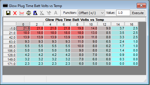

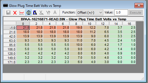

oh, I also changed the glow plug time vs temp table to get a little more time on the glows since my engine seems to start a lot easier when the time on the 60g glows have a couple more seconds.

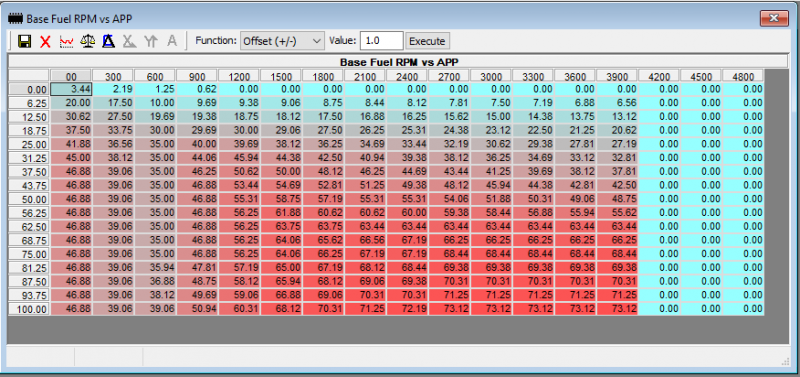

I have not messed with any of the timing tables yet frankly because I'm afraid to! here are some screen shots of the changes I have made compared to the way they were before. I have not taken my fuel mileage yet to see if there was any changes, I will post that on my next fill up.
Base Fuel Table Stock
Base Fuel Modified
Boost Table Stock
Boost table modified ( I did set code 78 when on the freeway but need to find the variables that sets the code)
Glow plug time stock
Glow plug time modified
I did set the SES light on while running this tune while on the freeway cruising at 70mph, but I think it's because the boost pressure was higher than what the variable is set for to flag DTC 78. so far I have not found the setting in there were it tells the code to set when above or below a value. I may need some help on that, but I am still reading and learning as much as I can when time allows me.
let me know what the thought are on these changes. I have been working on a second version if this tune adding slightly more fuel, and making slight changes on the boost table, high idle changes for both "in park" and "in gear" settings. I want to test it out later, but not until I get my current fuel mileage and do more research on triggering the SES light. also making sure my boost solenoid isn't failing!

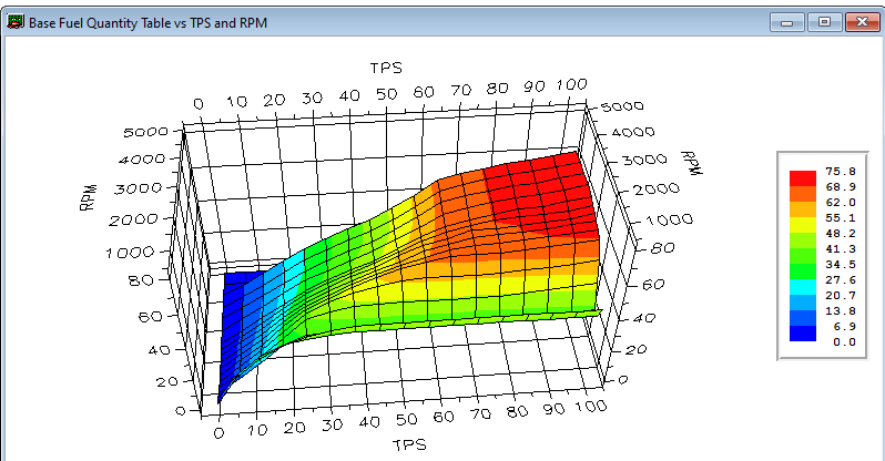

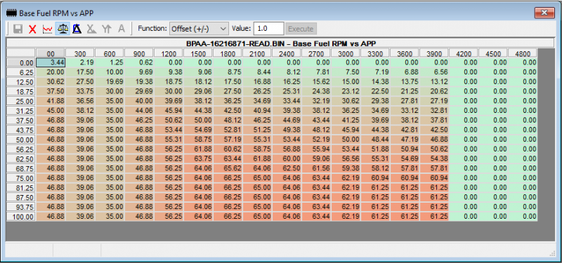

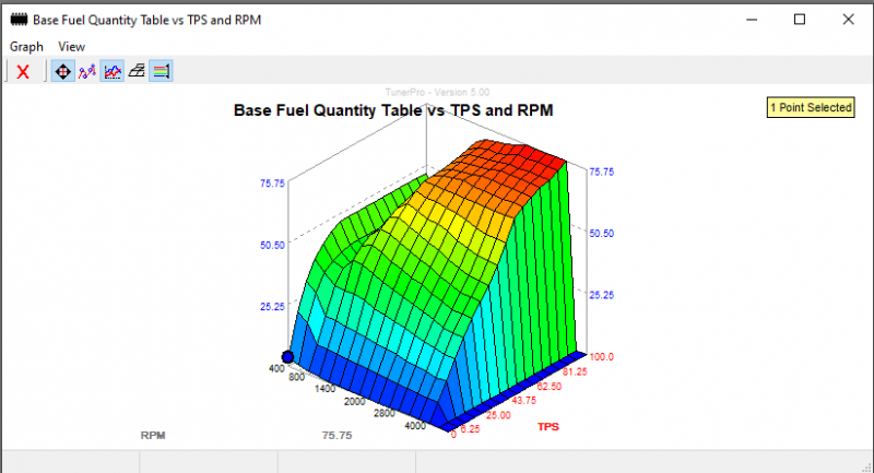

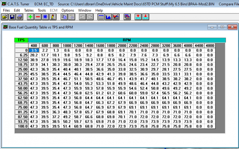

today I was looking at my tune I have been working on and something struck me as odd and I'd like to get some experts advice and opinions here. I was staring at the base fuel table comparing it to stock. I also managed to get the old application CATS tuner working as well by purchasing the definitions from Westers Garage.
looking at the base fuel table I notice that the mm^3 fuel amounts increase as both APP % and engine RPM increases. this made me think a minute about engine load where the only time you need more fuel is when the APP is pressed and the RPM is lower. when you reach the desired speed, the fuel should decrease as with the load. at higher speeds you will have the APP pressed further to maintain the speed, as the same follows RPM. your RPM will increase as speed increases due to the gear ratio and tire size weather you are just maintaining speed in cruise unless you are traveling down hill, then APP % will decrease as you let off the pedal keeping you at the same speed. in the table it shows the opposite. max fuel rate is only shown at max RPM and APP.
if I am thinking correctly, max fuel should be showing at max APP and lower RPM then lessen as the RPM is increased at the same APP %. let me know thoughts on this. Here is a couple of screenshots from both tunerpro and CATS tuner.
