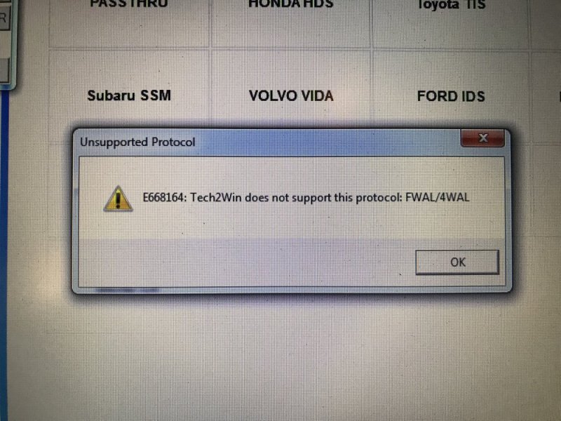

I finally got Tech 2 to work. It took a lot of fumbling and the opening of programs in a specific order, but it finally works. Unfortunately I got this message:
Sonuva!!!! That’s the one thing I bought this for and what I’ve wrestled with this thing for 3 days for!!! I’m going to contact the manufacturer and hope I get someone that speaks English.
