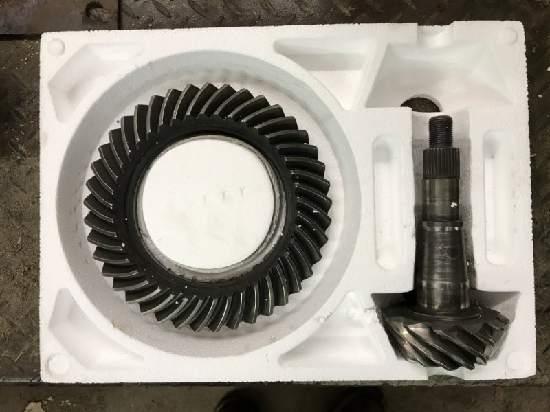

As mentioned in another thread, I have had some 3.42 gears for my 14 bolt waiting for installation. I have hated the Motive Gear ring & pinion ever since I installed them because they howl from 45-65 and make noise at other speeds, too. I set the gears up 3 times, having a good pattern each time and they always made noise. It wasn’t until AFTER I installed them that I found the bad reviews of the gears..... Once I installed the Moose and got the combo dialed in, this is when I decided I wanted to try a 3.42 gear - because 1st gear ends so quickly and it isn’t until 2nd gear that the truck really starts pulling. Some of that I believe is my torque converter, because it’s when it locks up that it really pulls and I don’t lock up the converter in 1st gear, but I also think a taller gear will help. So I went to Ebay and bought a used set of GM 3.42 gears. These will be getting installed and I can’t wait for them!

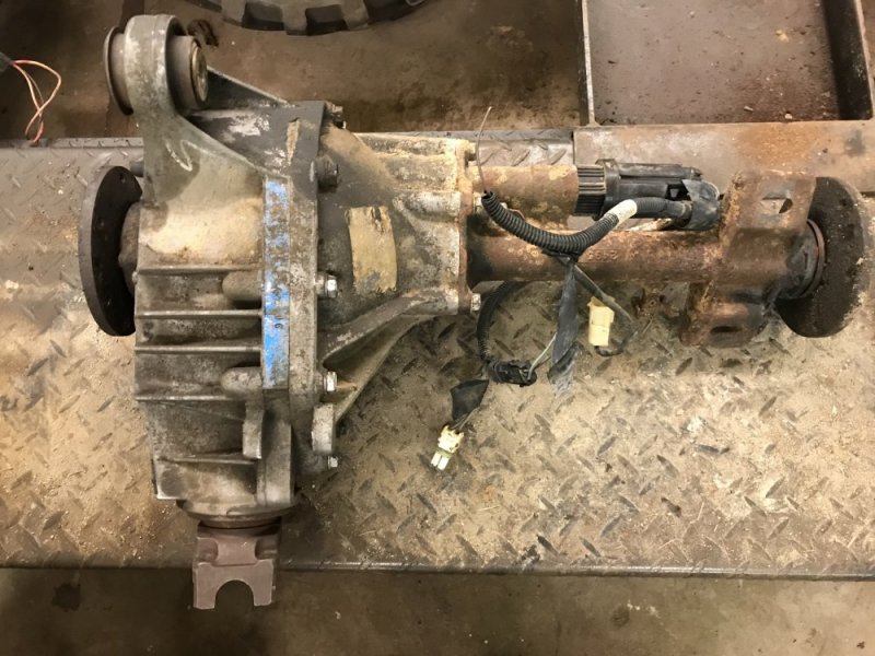

To go with the 3.42s, I just picked up a 96 front diff assembly. It already had the new actuator on it, so that’s nice. I took it to the pressure washer today to clean it up some. I will be installing a new pinion seal in it because it’s a little moist around the yoke.

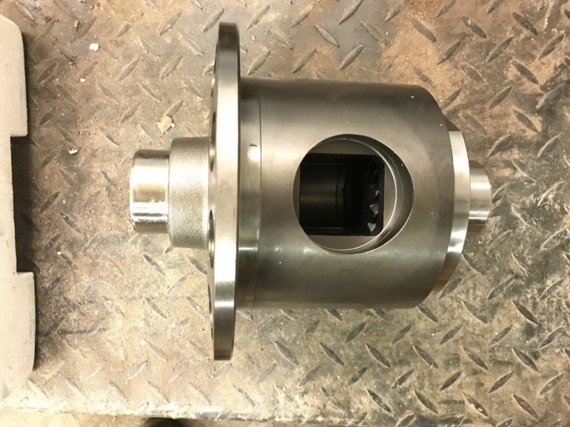

I didn’t want to install the rear gears on the old Gov-Lock because it feels like a ticking time bomb waiting to blow up. It inconsistently locks and unlocks.....sometimes I even get a left wheel one tire fire, so not sure what that’s about. And for a few months now, if I’m at highway speeds for 20 minutes or more, when I get off at the exit the locker will be locked the first time I go around a corner. Not impressed. I have been researching lockers for a while and the Detroit Tru Trac sounds like a tough, reliable unit that doesn’t take anything away from daily driving enjoyment. So I finally pulled the trigger on one. I will be so much happier knowing I don’t have a grenade in the rear axle waiting to go off when I start spinning thr tires.

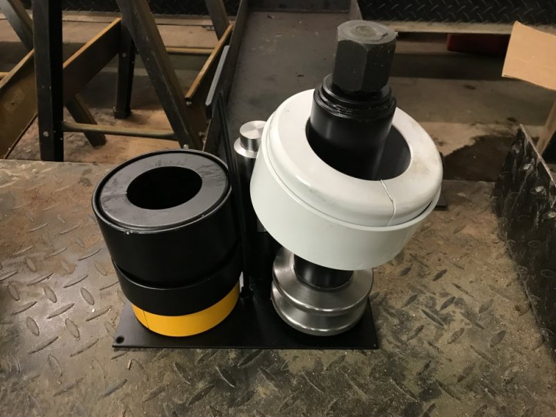

Since the bearings in the rear end are relatively fresh I wanted to try to reuse them. To do this I got a clamshell bearing puller. I’m sure hoping it works so I can save the bearings and also give me a couple shots at setting up pinion shim thickness without needing to destroy a bearing every time.

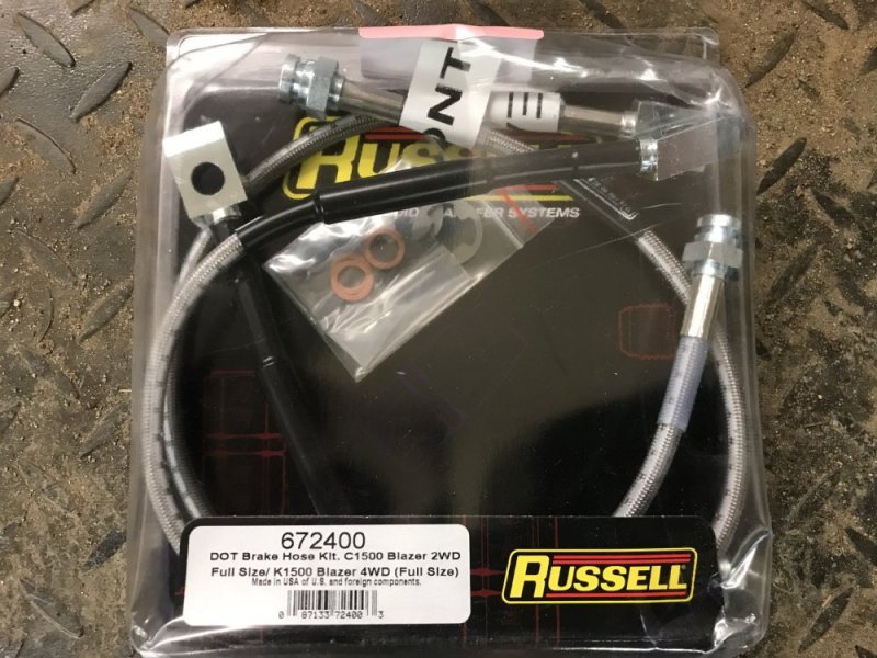

And then to finish up the brake upgrade I got some braided brake hoses. This should really firm things up I hope.
