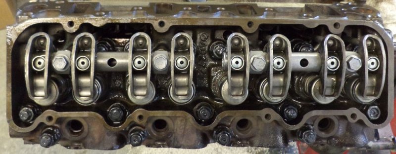

Blast from the past, here's mine.
56544
Don't remember who sourced the kit but Ted (635) bought them for the motor during his ownership.

Ok. That looks familiar. It was probably that one insaw years ago. I was thinking something with round headed bolts. Thanks.

I plan to use 3 flat brass washers which equal the same diameter and height of a single plastic nylon retainer with zinc plated grade 8 1/4” bolts and self locking nuts inside the shaft.I bought a package of 100 brass washers from eBay.Just trying to find time to get the rockers into place.
