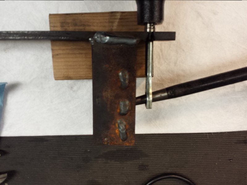

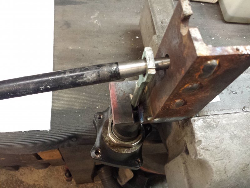

To use the GMT800 master cylinder that matches the GMT800 front/rear disc brakes, you need a GMT800 hydro-boost that matches the master cylinder (bigger diameter bore the mc mates into on the booster). But, the GMT800 hydro-boost uses a different length pedal rod. Also, to put new input rod seals into the hydro-boost requires the pedal rod to come off. So fab'd up a quick-n-dirty pedal rod puller. This is basically an evolution of an idea another 6.5'r (Haggar) on another forum used.
This gives enough leverage to pull the staked pedal rods, & puts the force on the input rod as I believe it should to do this right.
