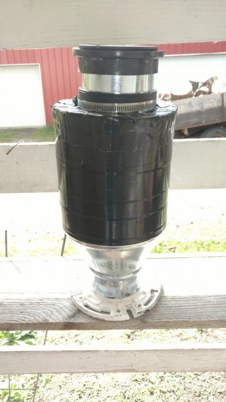

Better cold air intake via the Lowe's Depot.

To My experiences with them suction gauges, it takes a lot to pull them down, into the red.
I wonder what is going on with that, it appears You made a pretty nice system for a free flow of air.
If your pulling the intake side into that far of vaccum with a clean filter, the filter is too small or the tubing going from filter to intake is too small. By the diameter I saw, it point to the filter.
Do a 0-60 run with and without the filter in place and see if there is a noticeable difference.
Less smoke= more air allowing fuel to burn. So if there is a noticeable amount less, that means the filter or the plumbing is still holding back.
Of course, no telling how much worse it was before you made that change.
