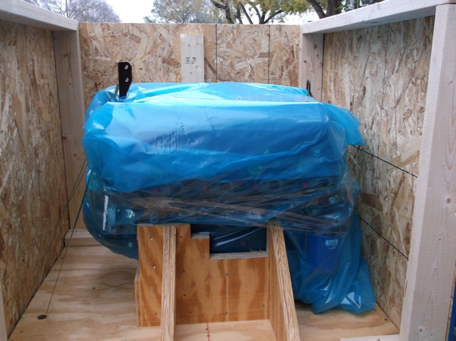

Engine banded and sealed inside thick plastic bag.

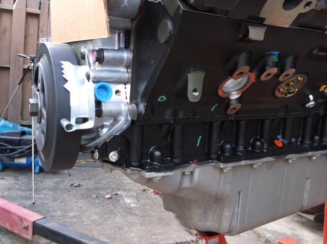

Got it on the engine stand. Jack stand onder oil pan to help distribute the weight.

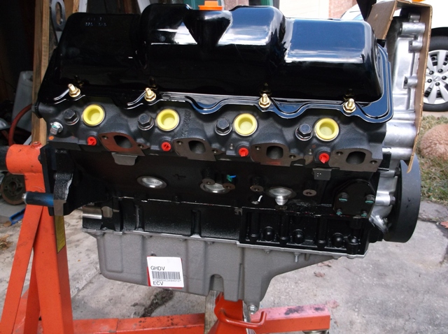

Driver side. Came with new block heater.

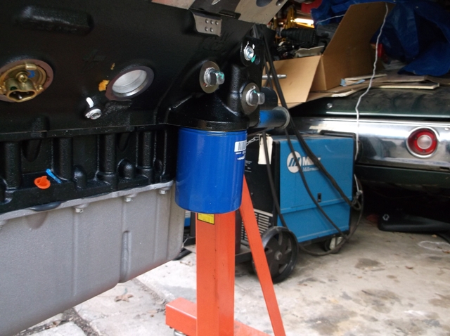

Comes with oil filter. Plugs in oil cooler ports.

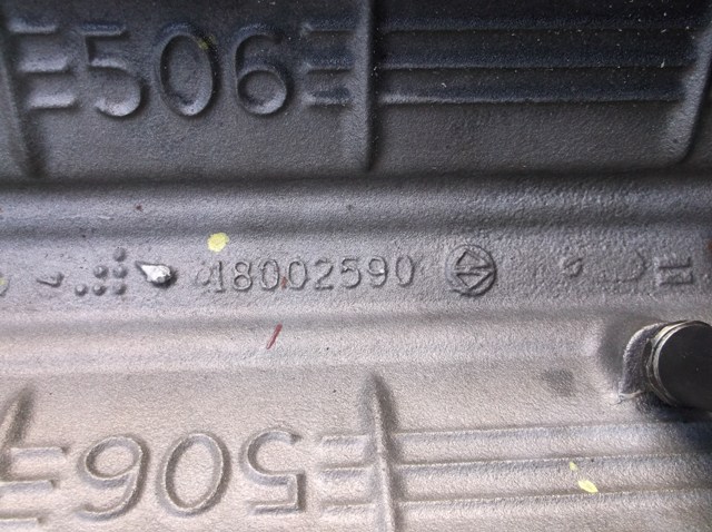

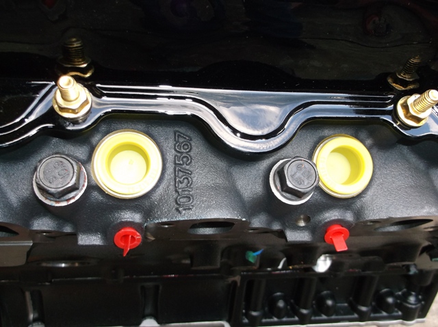

Head casting #s
506 and Navastar logo

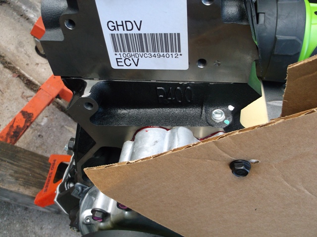

Herd to see here, but below the sticker in the black painted are is cast into the block "P400"

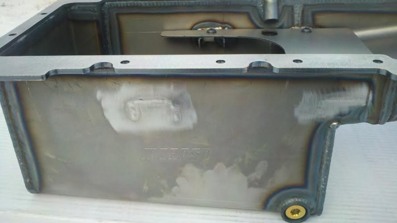

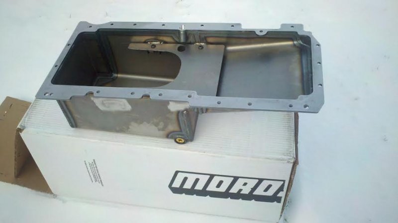

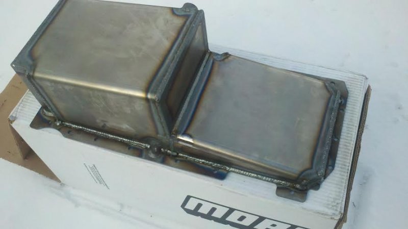

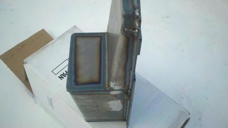

The Moroso pan from Leroy seems to be very well constructed. It weighs in at 13lbs 4oz. It's all Tig welded (not welded with jumper cables and a coat hanger like the one from pen). Hopefully I will get pix of my "Franken" pan on Monday. I'm also eager to see if I got a new block heater with my P400, I was too distracted by the header, turbo, "Franken" pan and the broken transmission to look at all the details. If it has a block heater or not, my plan is to install 2, 1 in each side. That way I'll always have a spare ready to go.
I was told by a couple sources that the stock P400 pan will not fit in a non-military vehicle, 2 or 4 wheel drive. That includes my Workhorse P30 chassis under my motorhome, even though I have independent front suspension (not a straight axel). I wish it did, as it would have saved a lot of time and money. Also the only thing that could have been better with the Moroso pan is it should have a bigger oil capacity. While the "Franken" pan holds about 12 qts, but it doesn't look like the Moroso pan will not hold much more than stock.moroso pan 1.jpg morso pan 2.jpg moroso pan 3.jpg moroso pan 4.jpg

I can definately build the engine to spec, but! depending on where you are the shipping cost could eat you up. Appox $300 to get it here then ??? to reship. Might be better to buy the parts (from me prefferably) then have local engine shop do the work.
I was told by a couple sources that the stock P400 pan will not fit in a non-military vehicle, 2 or 4 wheel drive. That includes my Workhorse P30 chassis under my motorhome, even though I have independent front suspension (not a straight axel). I wish it did, as it would have saved a lot of time and money. Also the only thing that could have been better with the Moroso pan is it should have a bigger oil capacity. While the "Franken" pan holds about 12 qts, but it doesn't look like the Moroso pan will not hold much more than stock.View attachment 43730 View attachment 43731 View attachment 43732 View attachment 43733
You and Jay got the first two "prototypes" future pans will also be cadnium plated. Just going from the pictures it looks like 9-10 qt capacity? Also with an investment like these I'd add extra filtering/bypass filter and get even more capacity.
