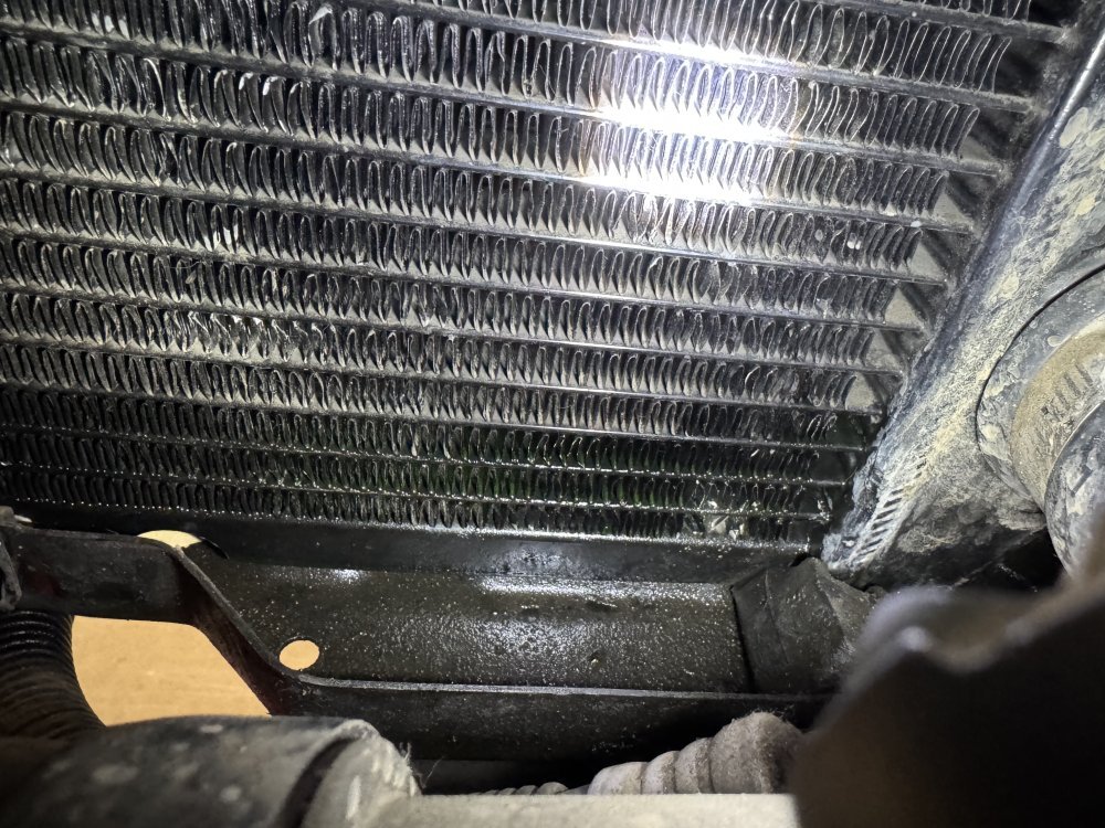

Yessterday, running chores.
Man at tire Rama tells me he seen a drip from under my truck.
I’m watching out for this in my travels. Drips out the left side like coming from the radiator drain cock.
Put truck in garage, relieve pressure, this morning small puddle under right side.
Install coolant system pressure tester, pump it to about 12PSI. No leeeks.
Remove top shroud, fan and bottom shroud.
Lower radiator hose dry.
Lower right corner of the aluminum Champion radiator.
I have used both products, aluma seal and bars leaks before.
Aluma seal i always buy in powder form. Mix about a half of one of those tubes with coolant, thoroughly stir and add to operating temp engine, install cap and run it.
Any opinions on which would be best on this aluminum radiator ?

Now need better pics of the area where the radiator is leaking.
This creates a delimma. I dont have time to pull the radiator because thats the only way I can get shots from different angles of the leak.
Both upper and lower shrouds need to be removed in order to get close and its not really possible to get any other angles of the leak.

1. Picture of the front and back of the radiator (must show the whole radiator in both pictures)
2. Picture of the defect area
3. Picture of the serial number
