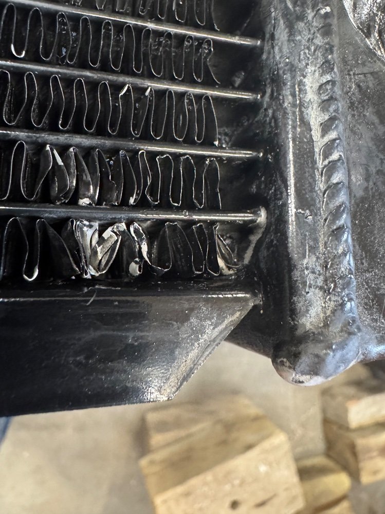

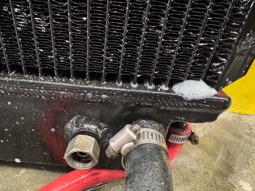

JB Weld. The old slow cure stuff. Used it dozens of times and never a failure. Couple quick scrubs with a steel brush, rinse with a little water then let it dry.
Mix up the JB 50/50 and put it on so that its about size of a quarter. Dab it in so a bit goes into the hole.
