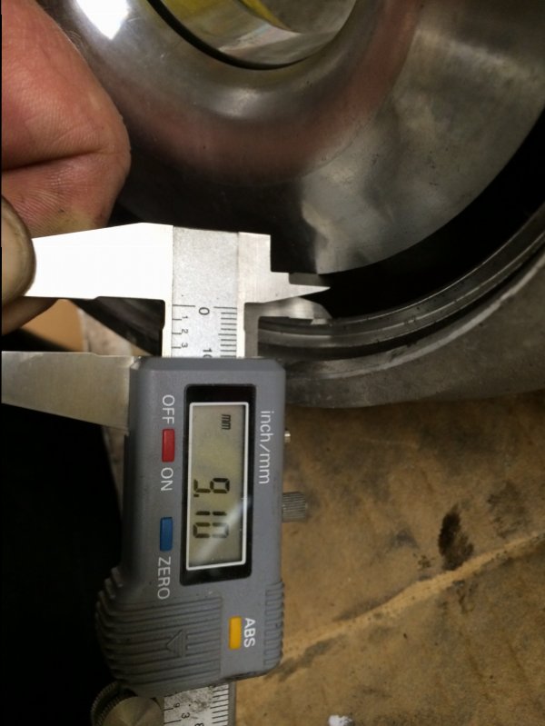

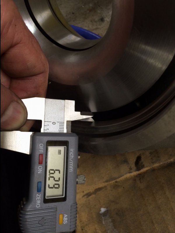

On a whim I tried changing the compressor housing on the turbo because I had noticed that the new one had a smaller gap for the air coming off the compressor wheel (see pictures below). Interestingly it seemed to help the problem, but it is definitely still there. So I'm not sure what the problem is. I'm going to try some data logging with Car Code and try to see what the differences are in the fuel and timing between when it's pulling strongest and when I'm at full throttle so I can talk to Bill some more. I still feel like it's a tune issue, but I don't have the info to back it up. Otherwise I really like the tune, it pulls really nicely at all throttle positions other than full throttle.

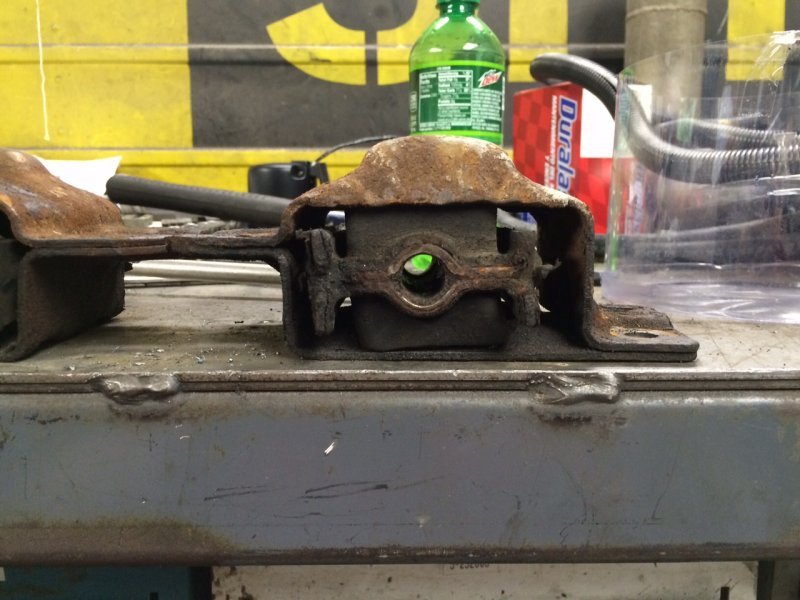

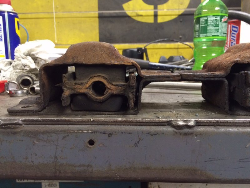

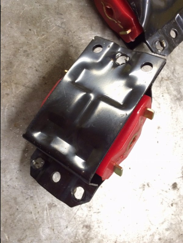

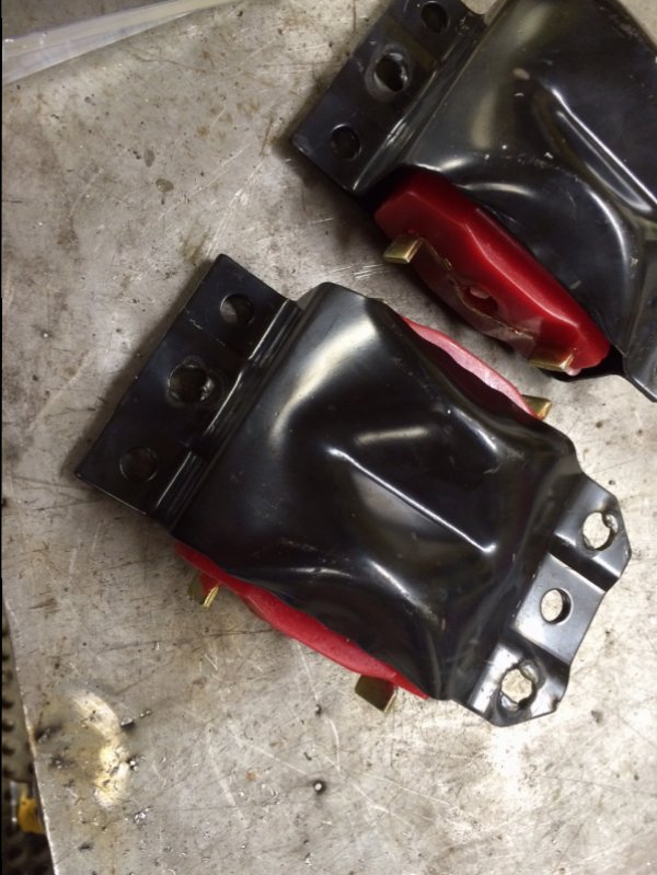

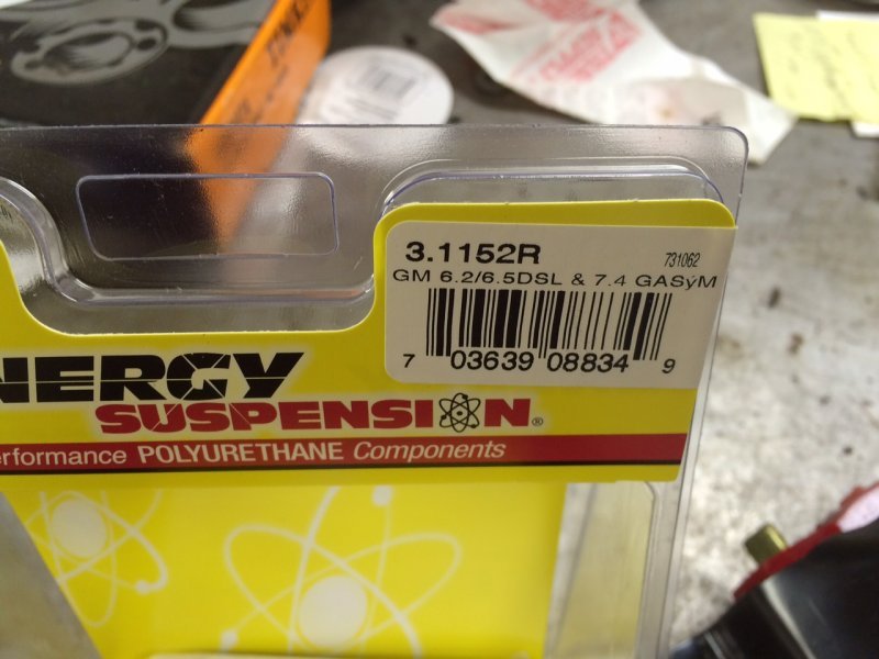

I do have another update. I was noticing that I had engine vibrations while driving down the road. With all of my other shaking problems I was feeling more and more that I had motor mount issues. So I bought the Energy Suspension inserts. I had purchased some new cheap motor mounts when I was buying parts for the Optimizer, but then found out they don't last long. So I gutted those and put the ES inserts in instead of the rubber. It took me just under 3 hours to swap the mounts, which I guess isn't too bad, but considering I could have done it in 5 minutes when the engine is out....it kind of disgusts me.
Anyhow, the moral of the story is that it's definitely smoother now!! I don't feel engine vibrations going down the road and it's much smoother at idle. I can still feel the engine at idle, but it's not obnoxious. All this time chasing this problem and it was intake tract and motor mounts. Ugh.
I hope somebody else doesn't make the same mistake I did. I thought my factory mounts were ok when I looked at them in the chassis, but apparently I didn't know what I was looking for. Once removed they are clearly bad. I was tired of spending money on the project, and I was afraid the ES mounts would be a little harsh so I thought I was making a smart move leaving the stock mounts in....the truck only has 144,000 miles on it so it's relatively low and I thought I was going to be ok on the factory mounts - NOPE. So I won't make that mistake again.

So I bought the Energy Suspension inserts. . . . it's definitely smoother now!!
In case your motor now makes a 'thunk' at shutdown, this will go away.

I had mentioned the mounts awhile back.........

Good to know on the mounts. Yeah it does do that...I was wondering if the mounts would "break in". In fact it has always done that since I've owned it and that was likely the bad old mounts all along.

Yeah I remember that...Turbovanman did too. I wish I had listened to you guys sooner :(
