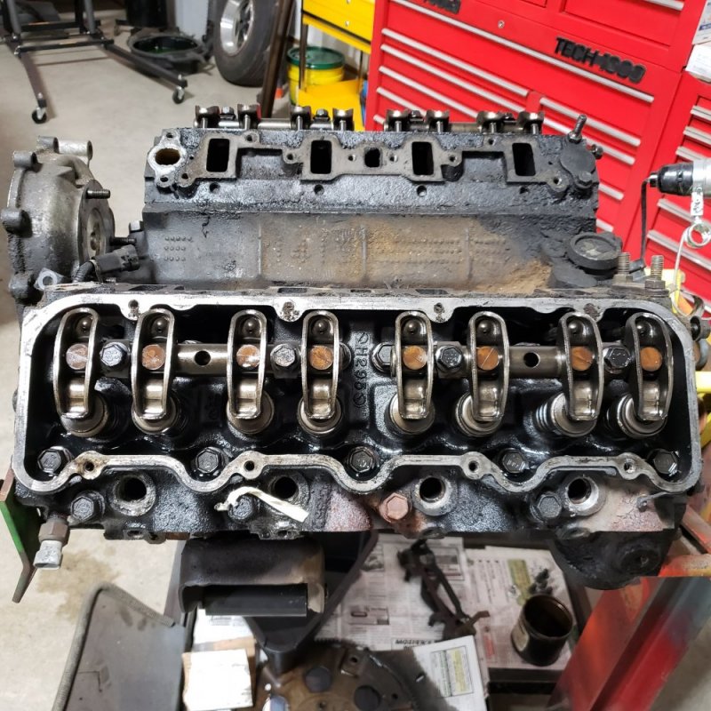

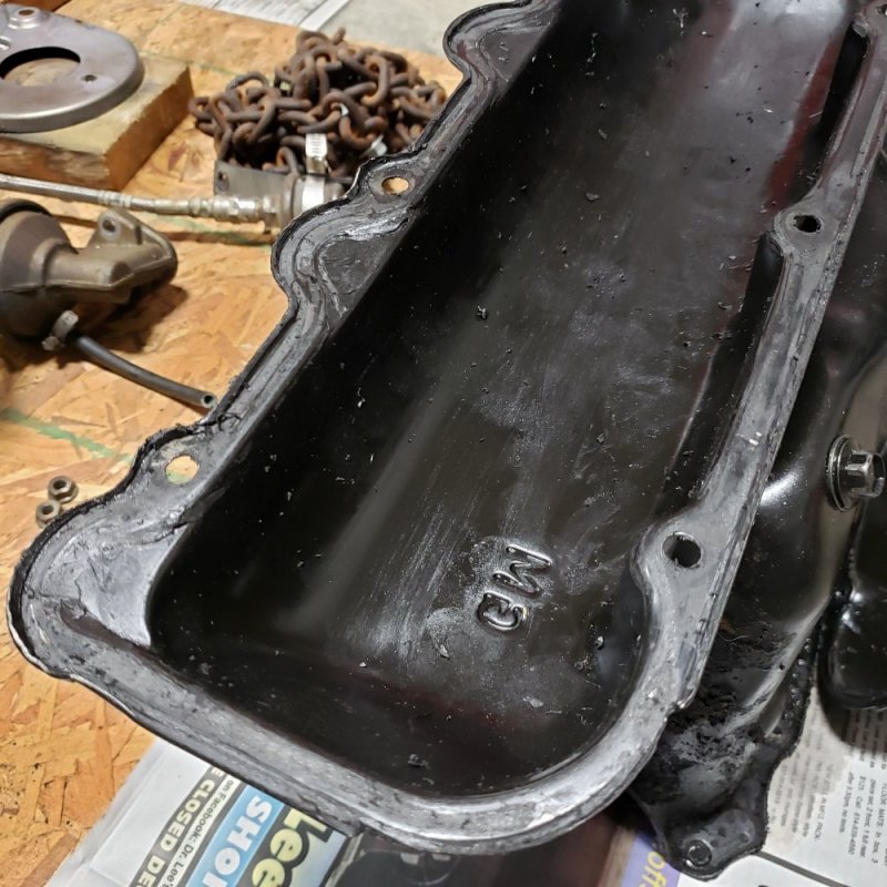

Successfully removed the original valve covers off the boat anchor. Not a big deal to a lot of you guys that have done it, but it was a big win for me. I'm thankful I practiced on the donor engine so I didn't destroy these. They came off beautifully. Driver side took a long time and a lot of work. Passenger side seemed like it was barely stuck in place - I knocked the top loose and a little down one side, then it came off in my hands.
