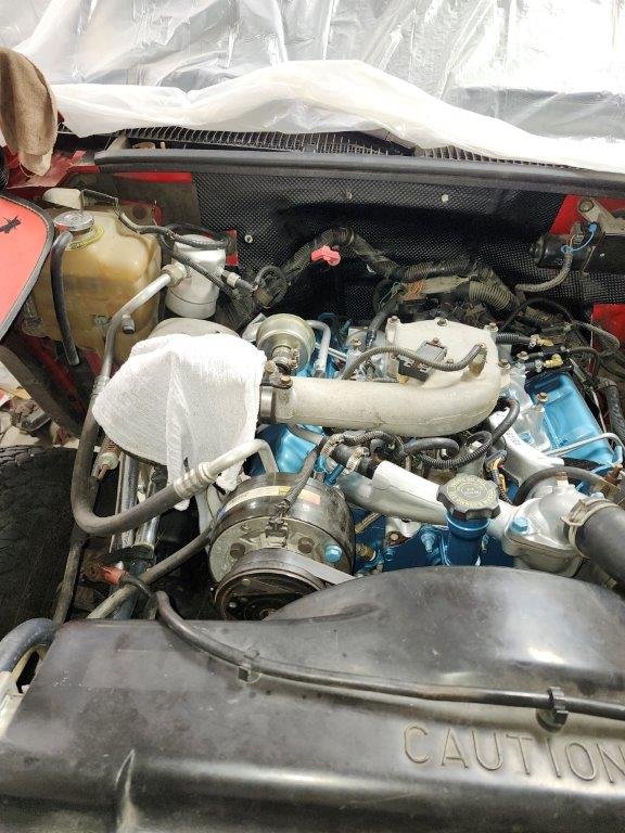

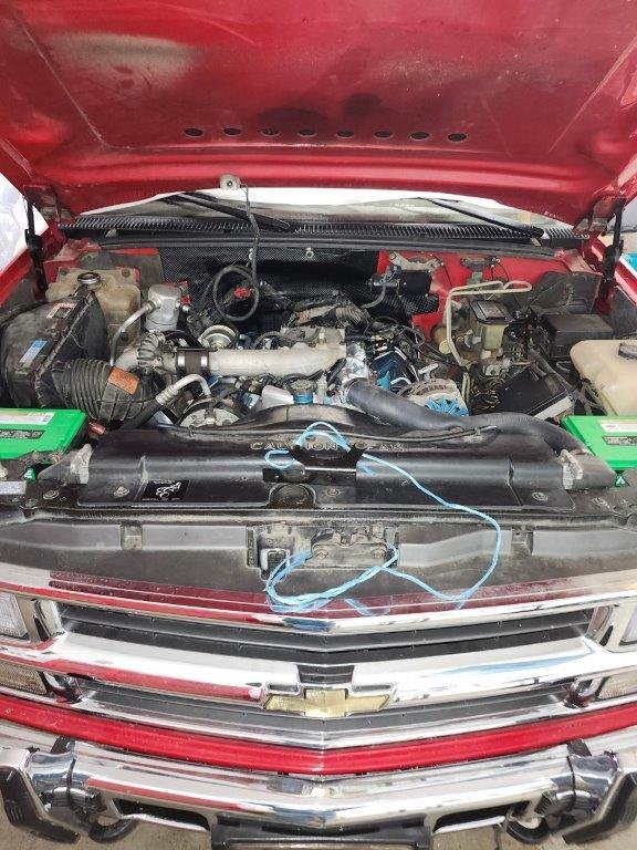

Up above, the turbo is setting on the manifold and the upper intake is in place.

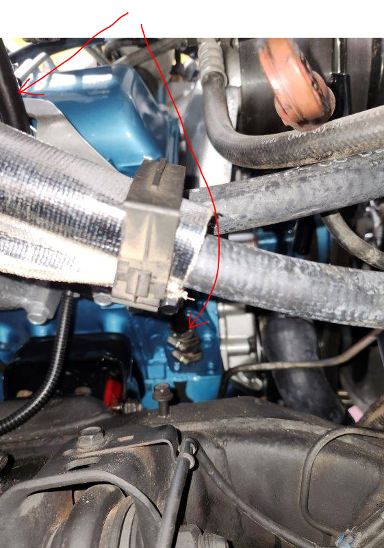

If anyone is wondering, this drain tube CAN go on after the manifold is in place without issue, but I would HIGHLY recommend getting it in place before the heat shield for is in place. I've heard it can be a real challenge otherwise.

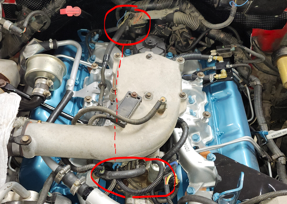

Since I apparently miss things from time to time, I left this harness for the injection pump off until today rather than fitting it up and laying it in the valley before I installed the lower intake. I wouldn't recommend it though. If anyone wonders, it CAN be routed underneath but it isn't without it's challenges.

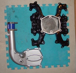

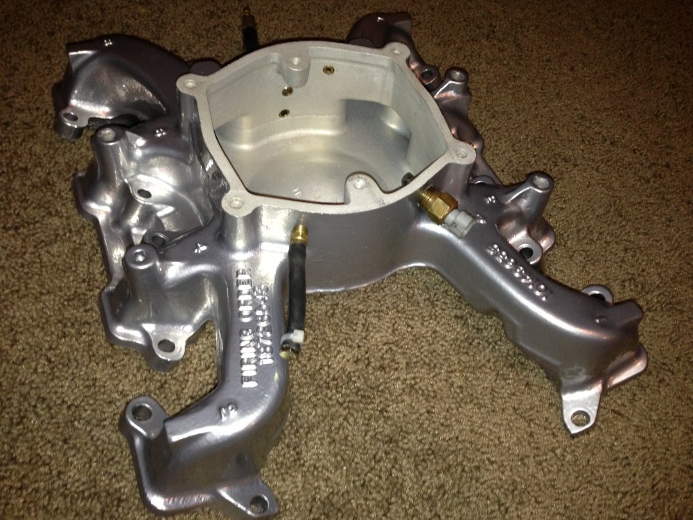

Since the upper intake will be getting changed soon, I didn't see any need to paint like the rest. It's ugly for the moment.
If the Bill Hirsch coating I have holds up, then I'm pretty happy with it. I like the way it looks on the cast pieces. Even brushed on, it still looks smooth. We'll see how it goes after some heat cycles, though.
Yours looks really good but after all the steel part I had powdercoated cracked the coating around the bolts, I'm not a huge fan. Maybe there's a flexing agent in the automotive parts typically that these didn't get. My first experience with the powdercoated parts hasn't really been a great one.
Nice! I do have a question.... is that an aftermarket hood? I noticed it's solid on the under side with what looks like breathing holes near the back.
One point on the powder coating of the upper and lower intake. Bolts making contact with the intake’s bare aluminum surface provides a path to ground for the Air Intake Sensor. My AIT sensor couldn’t get a path to ground until some coating was removed around the bolt holes (at least one).
