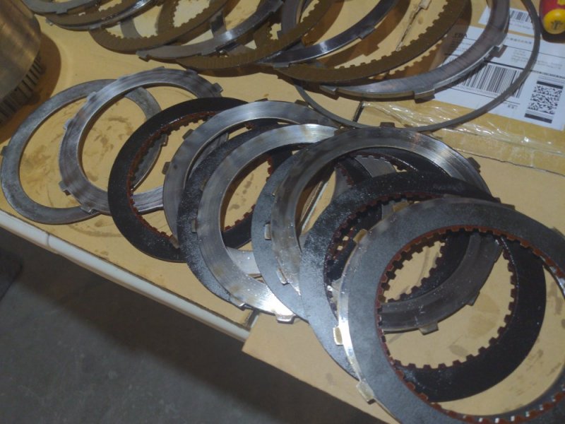

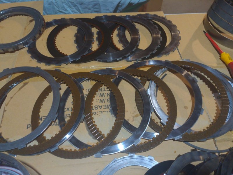

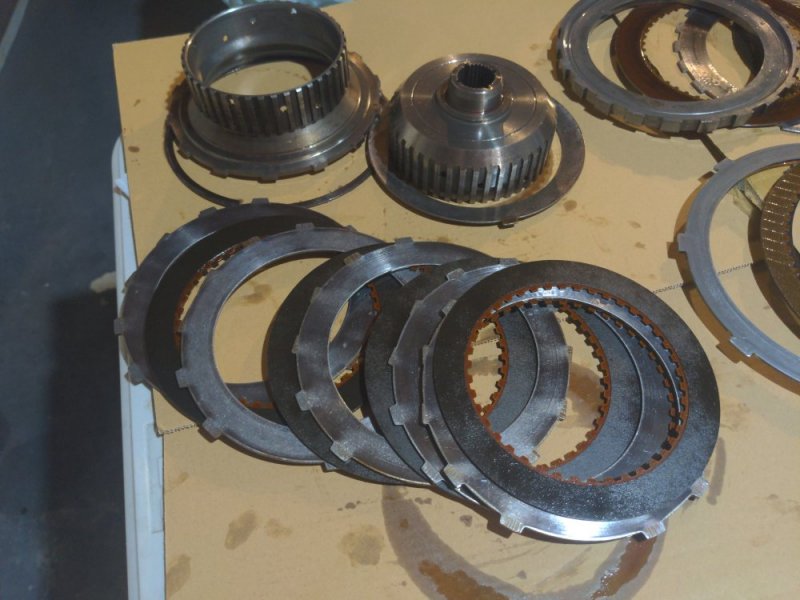

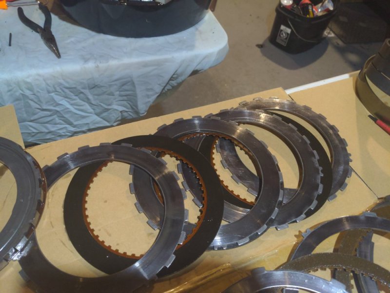

You were right. Pulled the pan and lots of black crap in the oil again, probably worse than last time. The PCS solenoid was clogged up with junk again as were the screens. I pulled the trans out though and looking at the clutches I can't really figure out where all this is coming from. Most of the clutches look great except some indications of heat on the steels of the intermediate clutch. Not really sure what to look for here to determine what exactly went wrong. Any ideas?
The oil I dumped out of the TC looked the same as everywhere else, no loose friction material or anything coming out of there that I saw
Dismantle the pistons too. Be sure that their cavities are not loaded with debris.
I really wish i had a way of looking at the clutch inside the converter to see if the black crap is coming from that. Because looking at these clutches, i cant really say with confidence that its coming from them. But unfortunately, if i cut apart the converter i will lose my core charge and i have to imagine thats pretty hefty on this.
I do wish i knew if the converter was causing my problem though. This crap has to be coming from somewhere!!
Well when the trans went into the vehicle it had a reman pump and a reman converter, with a full kit (clutches, bushings, seals, bearings, paper gaskets, etc). The converter i picked up at a trans shop and swapped them my old one. So when the full trans went in the vehicle it definitely got a different converter however i cant vouch for the quality of it.

The blueing on the steels is from low line pressure. The clutch material is most likely from your converter. It sounds to me like you rebuilt your trans without finding out why your trans failed in the 1st place. Transmissions do fail, but the majority of them fail because something else takes them out. You always, ALWAYS find the root cause of the initial failure BEFORE putting one back together. This is the single biggest cause of repeat failures is repairing the failure without finding the cause of it, and then the repaired unit fails in the same fashion again and again. You're going to have to set down with a manual and vacuum check every circuit of your valve body, pressure check each clutch circuit and look for pressure leaks, and go over it with a fine tooth comb. With the quantity of clutch material that you have in yours you will most likely end up having to replace your radiator and external trans cooler as it is next to impossible to fully flush them. Then after putting it back in hook up a pressure gauge, take a bidirectional scan tool, and verify that you have the correct pressure for each amp step.
And Dex vi is fine in a fresh rebuild as the new seals will be compatible, it is seals from before 05 that were the problem.
